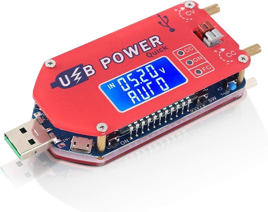

Look at the Step Down Voltage Regulator rather. But I don’t see any point in doing it for one phone.

As I mentioned before, think about the voltage regulator…
Something like that
Over-Current Protection: Module will turn OFF output automatically if output current is more then 2A.
Imagine your phone is there instead of Pi.
Then you need a USB-C plug with an open end…
USB-C can be replaced with usb-a / micro depending on what you need for the phone.
