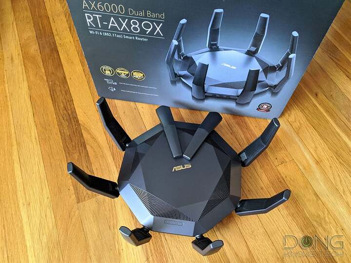

Their naming convention is pretty poor - they are all called AX6000 - but my specific model is the RT-AX89X which has two 10gbe ports (one Base-T and SFP+ port)

Ah, you said you had an AX6000 and I thought that meant you had an Archer AX6000. You have an Asus RT-AX89X with “AX6000 capability” which is marketing BS. That is why I thought you didnt have a 10gbe port on your router at all. lol
So yes, with that router you will have a 10gb connection from your NAS to the router. Your router has a single 10gbe RJ45 port, but also has a 10gb SFP+ port. So theoretically you could get a 10gb SFP+ NIC in your PC (or, does your NAS use that port?) and connect your PC and NAS via wired 10 gigabit network with just your router and no extra switch needed. This would let your PC write to your NAS’s RAM cache at around 1GB/s, or read from a cached file at that speed between them.
