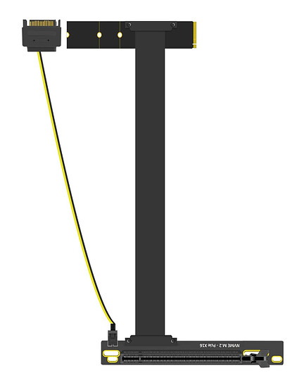

Keep your eyes peeled on ebay. The aquantia based ones with the red heasinkbwere around $70-90 6 months ago. You could get 15 for $1k from ali express also but I don’t see any good deals right now. If you’ve got room for it though you can break out an m.2 to a pcie x4 slot vis cable and use an Intel x540 or 550 and still get it all for around $100 or less

Looking to do something similar here, is there any reason to not simply use a m.2 to pcie x4 riser and typical riser ribbon to my existing gen3 x8 dual sfp+?
Obviously it will negotiate to x4 speeds but that should not be too limiting even for 2x10Gb bonded

Amazon M.2 to Intel 10G SFP *Slot-Type.
Edit: Just want to add you still have to buy an sfp ethernet module. Which is part of why it’s so cheap.
44USD at time of posting.
This nic is kind of awesome as it doesn’t have standard pins on the expansion card so it may fit in a slot between fat graphics cards. Instead it connects to what I am assuming is a repourposed sas connector. I bought 2. Will let you know if anything is weird.
Would also not reccommend 10g copper ethernet. Power draw difference is nothing to sneeze at. Not to mention my microtek 10g switch over heats with just 3 copper 10g sfps. If you have the empty sfp slot type on both ends consider a Direct Attached Fiber Module.
I have purchased both and will edit this post later with the performance.
I just bought this and installed it yesterday. I works great with x540-t2/x550-t2.
Even with pci-e x4 with x540-t2 (pci-e 2.0), there is no issue to max out single 10Gb port.

Something I’ve never thought of: How would one see errors on the pcie express bus? If the cpu - controller card was getting errors introduced due to the extension cable on the pcie lanes?
