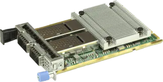

Not looking to hijack the thread, but I have a similar dilema. I’m looking for recommendations on a 100g NIC for TrueNAS/FreeBSD. Based on my expierence Intel NICs are pretty much plug and play, but the reason I’m looking at the ConnectX-6 card is comes in AIOM form factor for my Supermicro Chasis. On my build I have the AIOM slot and one PCIE x16 slot available. If the reviews are possitive I’ll probably go with the ConnectX-6 simply based on form factor. I can use an Intel 100g NIC in my x16 slot, but then have to figure out a new config for my HBA. Anyone played with the ConnectX-6 on TrueNAS or FreeBSD

Not married to infinityband by any stretch. I should have clarified the card I was looking at was the Supermicro AOC-A100G-m2CM which uses the ConnectX=6 Dx controller.

Well, my ConnexctX-6 Dx cards work fine (and on my Supermicro boards as well.) But my comment was less an endorsement and more, “if you’re going to go ConnectX, save yourself a headache and just get the Dx cards.”
