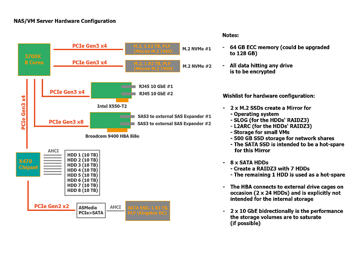

I’m looking for help squeezing every feature out of a given hardware configuration (every part is already at hand):
Its goals:
  • Saturate 2 x 10 GbE ethernet connections
  • Provide a Mirror on SSDs for the Host OS, ZFS “Caching”, Guest VMs (Router, VPN, “light” stuff) and around 500 GB of space as a network share
  • Provide a RAIDZ3 on 7 mechanical HDDs
  • It would be great if the VM Host could support AMD’s Secure Memory Encryption feature where the memory of host and guests is automatically encrypted separately to achieve a bit more separation, HWiNFO says the feature is active on the system.
Can you guys help me achieve all points?
  • I hate to admit it but I still “feel” most at home with a hardware RAID controllers and never really trusted myself going full ZFS
  • If I’m able to reach all of the goals (see a little more details in the graphics file), I’d be finally content.

Nope, the system has a KVM IPMI. Otherwise the dGPU would have been in the diagram.
That’s another reason why the dedicated HBA isn’t planned to be used for the fixed internal storage, makes it painless to swap it for a dGPU in case an actual modern GPU feature like media transcoding is needed for one of the VMs.

Questions for you:
-What will the workload for this server be like? Is this going to be mostly sequential or random 4k? Read or write intensive?
-How is this data going to be accessed or exposed? Eg.: Shared out to other devices (like windows) through file shares (SMB) or mostly accessed by linux/unix/apple/other-devices over a network (ssh, NFS, iSCSI, etc…)?
-Which is a higher priority for you - Speed, capacity, or somewhere in the middle?
-Are there plans to increase the number of perma-connected drives in the future?
