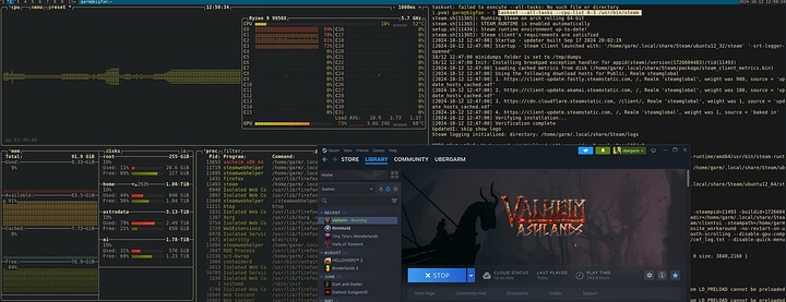

And good point, regardless of one or two v-cache, you can pin a process to a single CCD with something like:
# psure first 8 threads are on a single chiplet, 8-15 are on the second?
$ taskset --all-tasks --cpu-list 0-7 /usr/bin/steam
Not sure if you start /usr/bin/steam like that if processes it spawns will inherit settings? Or do you have to get creative or pin the PIDs afterwards or use a script? (launch options seems to be additional arguments…)
Anyway, regardless of the 9950X3D v-cache design, definitely some Linux tools to wrangle processes onto the best cores…
Last time I checked taskset was inherited.
You could set it for steam, start a game and check with the tool if affinities stay.
Nice, yeah just did a quick test and updated my post to include --all-tasks to ensure spawned threads inherit affinity.
Seems to be working when I force valheim onto threads 0-3 in this screenshot (game is not visible, but running on workspace 3).
