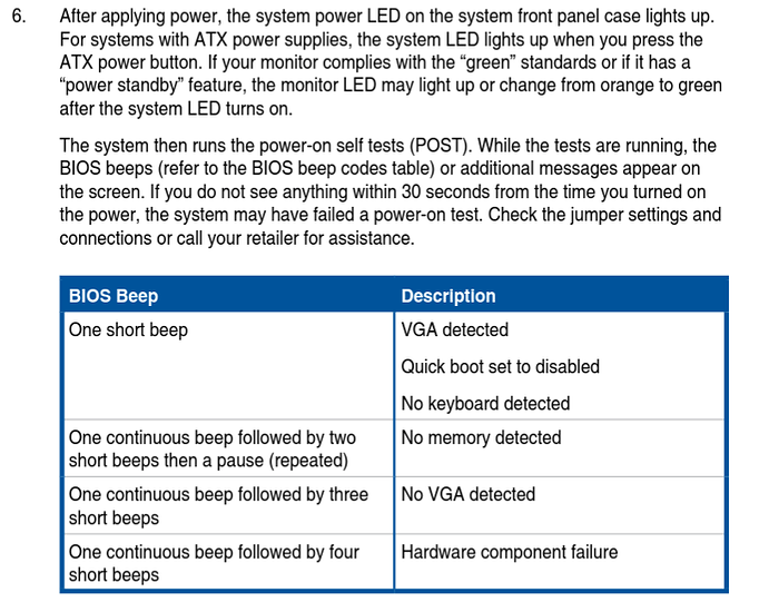

ASUS maintains resources for their library of products. This is the link to the manual.
Chapter 2.3 describes error behavior.
What do you observe?

I don’t get any beeps when trying to use the power switch or short the power switch pins. It doesn’t look like it’s even getting to POST.

That’s very unsatisfying as it doesn’t provide a lot of data.
