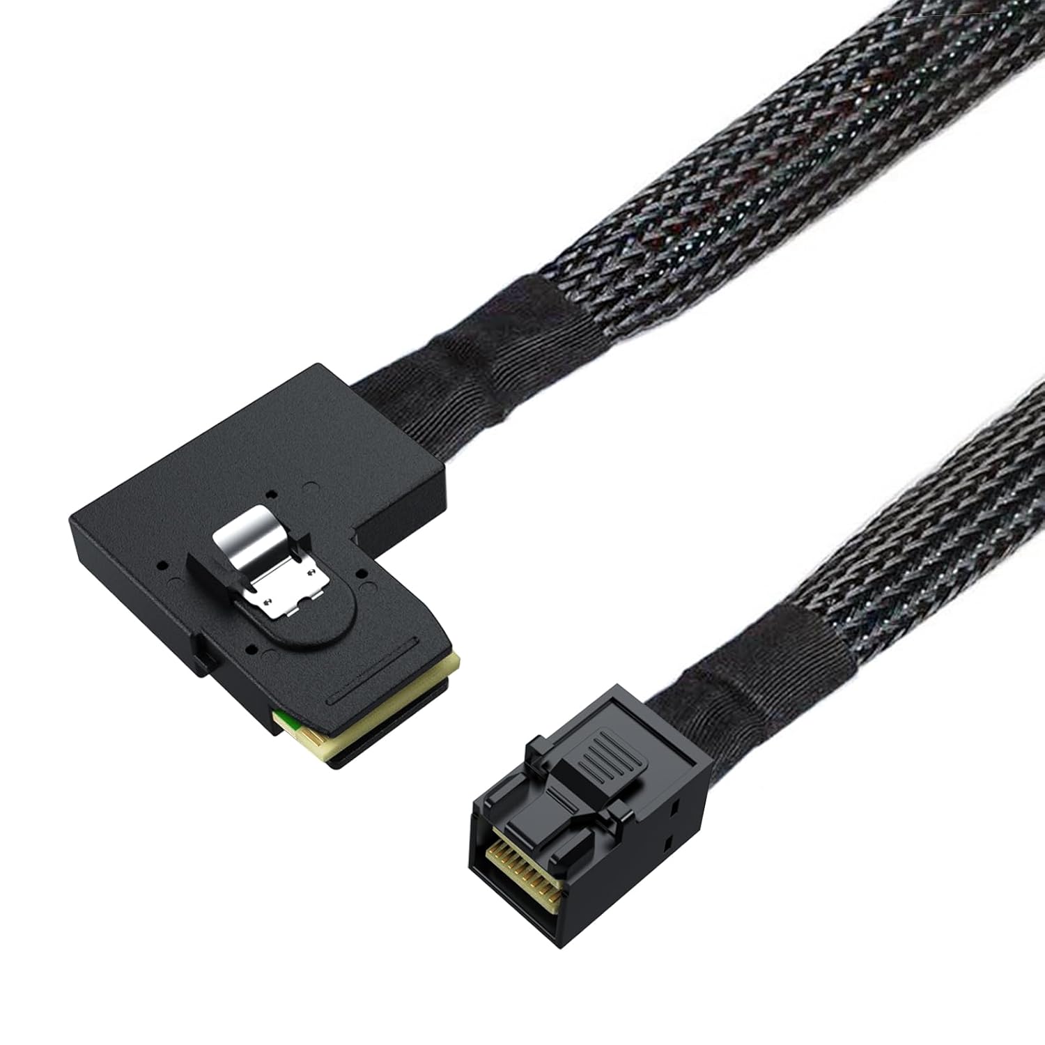

The Norco has SFF-8087 Mini SAS connectors and SATA/SAS 6G drive bays, that’s SAS2.
The SAS3 card is probably overkill when your bottleneck is mechanical hard drives. For what you’re spending on this card you could get a chassis with a proper SAS backplane and get away with using a single SAS2 card. My server can have all 24 drives running off a 4i card.
I’m pretty sure sas is backwards compatible. With both previous generations of sas and sata.
When you say “proper SAS backplane” I suppose you mean it would have a single connector, unlike the Norco where it has 1x SFF-8087 per x4 drives?
Our backplane compatible with SAS-3 (12.0 Gb)
That’s at least the Norco supplier’s response; not sure if that’s the actual truth though.
