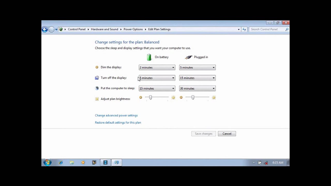

found this. is terrible but you should get the jist
I found the menu but I really don't know what I am looking at other than tiny bullshit.
I think I fixed it but because M$ can't make a menu make any fucking sense to save their lives I'll have to see if it crashes or not to find out.

alright. rebooted into windows for you.
It is under PCI Express
then link state power management
Do I leave it turned off or turn it on?
try maximum performance
or off
Theres off, minimum power savings, maximum power savings.
off. was thinking of something else
