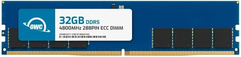

I have the Asus B650 ProArt as well, and I used four sticks of this
OWC 32GB Replacement for Kingston KSM48E40BD8KM-32HM - DDR5 4800 PC5-38400 CL40 2Rx8 288-pin 1.1V ECC Unbuffered UDIMM Memory RAM Module
  • the modules seem to be re-badged Samsung DIMM’s
  • make sure to enable ECC from within the BIOS
the “memory training” took a long time on some of the first boots but once I got past that, there was no issue with these. In the 4x DIMM configuration they run at 3600MHz which is the standard for many / most AM5 CPU’s I think. I did not try to overclock them (and dont plan to), and did not touch the memory settings at all inside BIOS except for enabling ECC. I did a Memtest86 run through and it detected ECC and had no errors. Been running fine for some weeks now. Total memory for the server is now 128GB. Would have been cool to have 192GB but this was good enough for me.

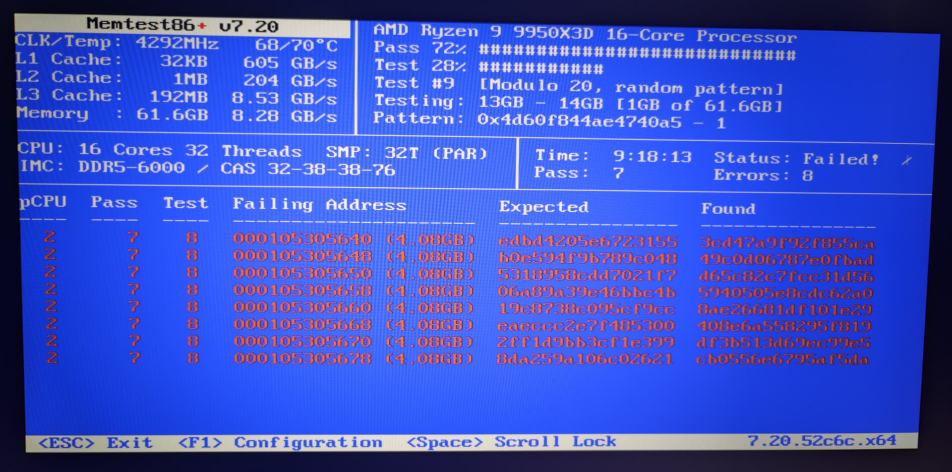

The board detected an AEMP profile for this kit at 5600 38-38-38-76 at 1.25 V which boots without issue, memtest pro ongoing.
Despite the “Disable Memory Error Injection” BIOS option to false in AMD CBS/DDR Options/DDR RAS (and of course ECC enabled), memtest pro does not succeed at injecting correctable errors.
Lines show [ECC Inject] Injecting ECC error for AMD Ryzen Zen 4 (60h-6fh) but no errors are detected afterwards

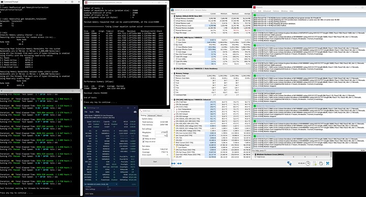

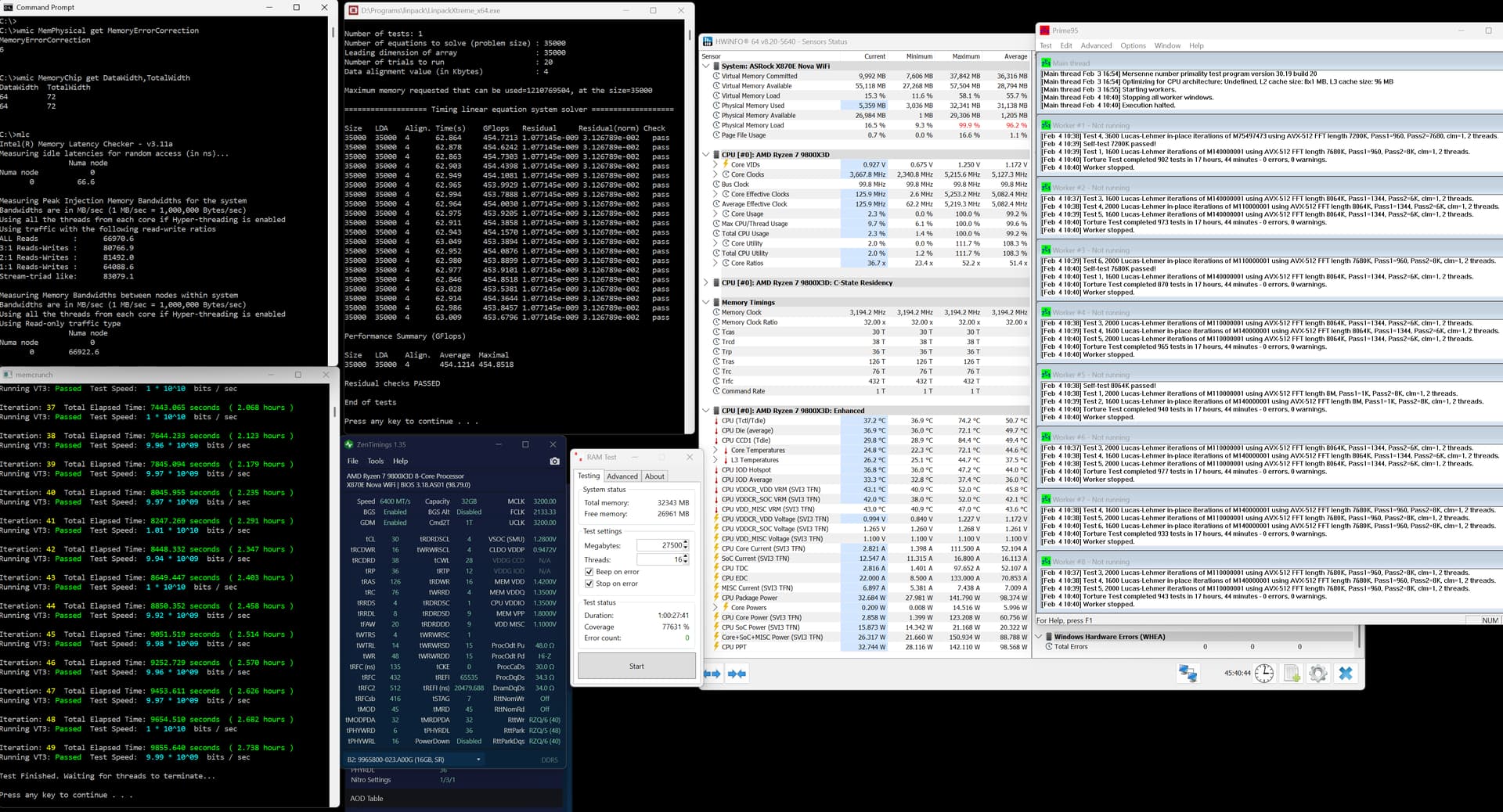

I finished my tuning with a satisfactory 6200 Mhz 32 38 38 126, using Buildzoid timings for the rest.
FLCK at 2133 Mhz, temp during stress at 70°C
No errors in Memtest Pro, and also with anta777 extreme profile for memtest5 during the whole night.
It’s nice to see that ECC sticks can perform as well as non ECC ones (which is king of normal since they use the same Hynix dies) !
