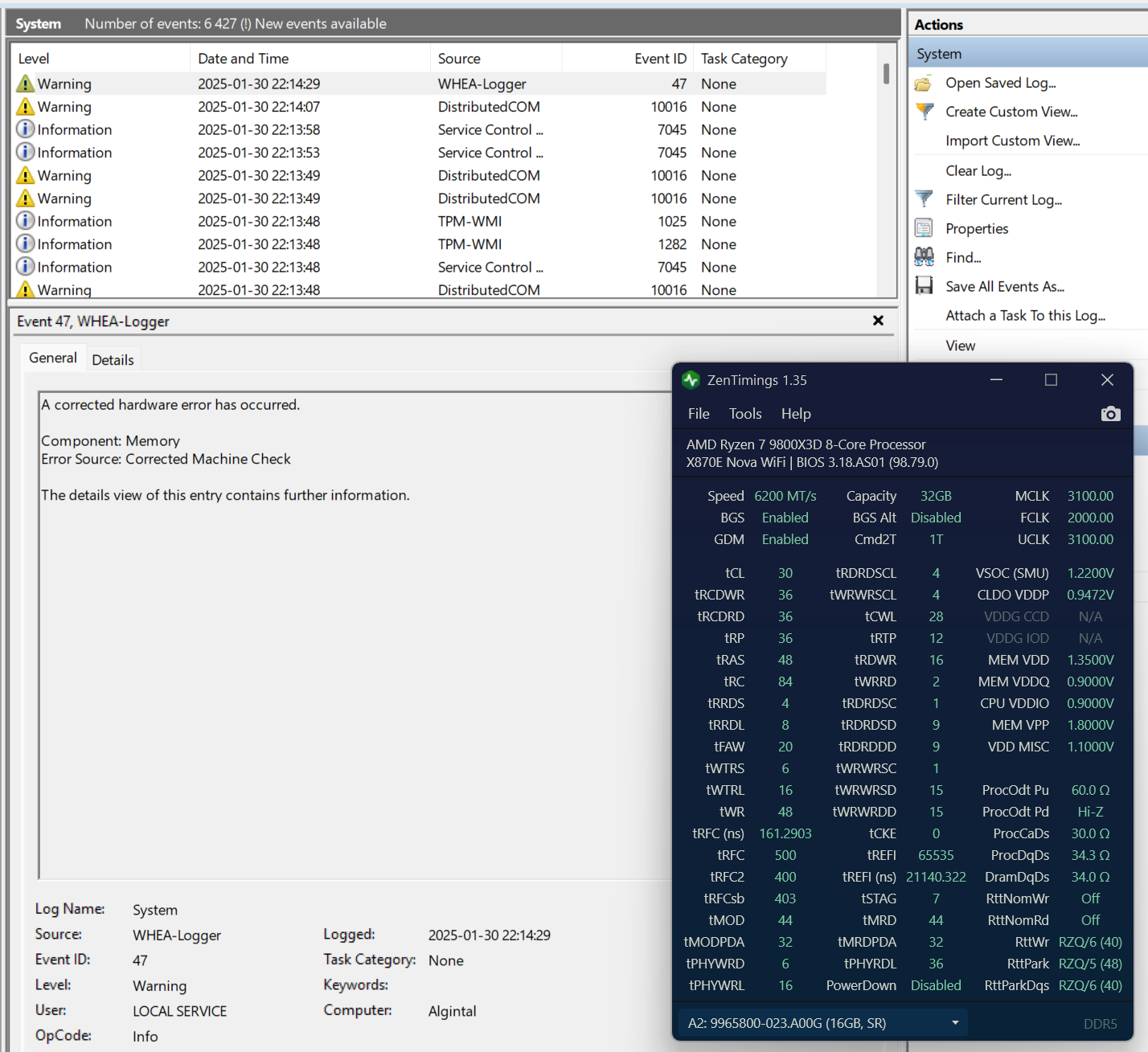

Follow-up to this: I think I’ve managed to prove to my satisfaction that ECC is working and that corrected errors get reported via WHEA. I found some guy on Reddit who figured out a simple way to get correctable errors - set the frequency as high as you can while still getting into Windows, then lower VDDIO and VDDQ significantly and eventually you’ll start getting WHEA warnings about correctable memory errors. And indeed, with ECC enabled and VDDIO/VDDQ set to a fairly ridiculous 0.9V, I get the expected WHEA events basically as soon as I get into Windows and start Zentimings and the event viewer:
The system is very unstable like this, and I can’t recommend it for the faint of heart, but as crude as it is, it does seem to prove the ECC reporting works. I tried rebooting with these settings a few times and got the exact same result every time. Just to further drive the point home I disabled ECC in UEFI and tried the same thing yet again, but as expected I got no WHEA events then. I messed around a bit trying to provoke one but with no luck, and when I launched an actual memory stress test all that got me was a BSOD for my trouble, so I’m pretty confident in my finding that ECC does correct and report errors.

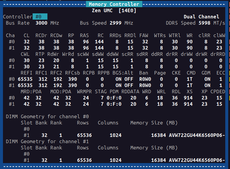

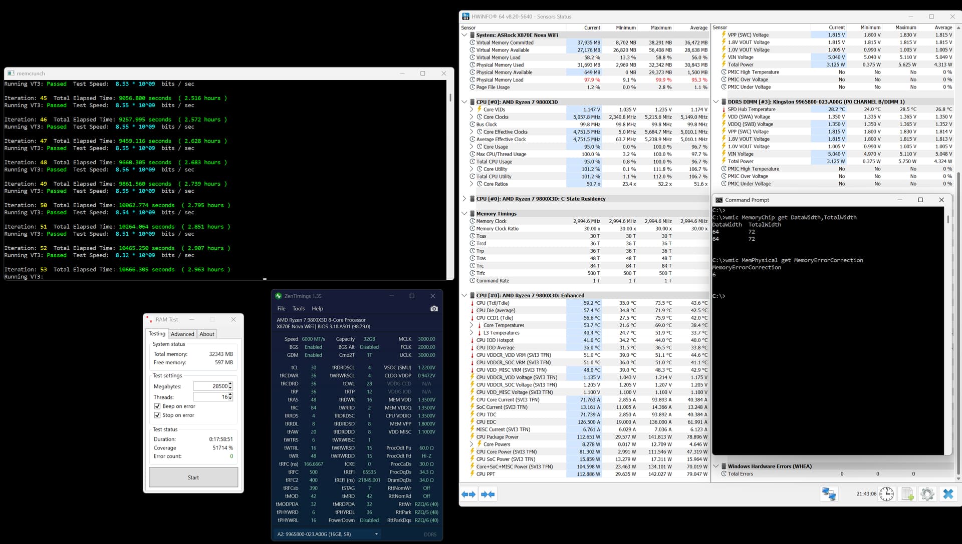

In other news, DDR5-6000 CL30 with modestly tweaked subtimings (just basic Hynix stuff) and not-sabotaged voltages seems to be perfectly stable though:
Also did 10 hours of Prime95 large FFT’s, no errors there either.

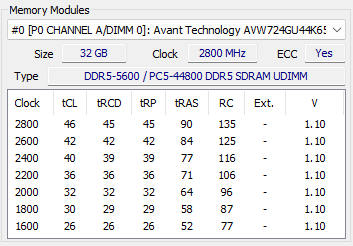

Here is the timings for the Nemix DDR5-5600 kit with ProArtX670 board AEMP timings applied.
Screenshot from corefreqd utility which is the closest thing to Zentimings on Linux I’ve found.
ProArt X870E does not pick up on the AEMP profiles in the Nemix sticks so it’s just using the SPD as follows when I select the target speed:
Nemix 5600 SPD
Test results so far. I didn’t test all the speeds though since a single memtest takes like 8hrs.

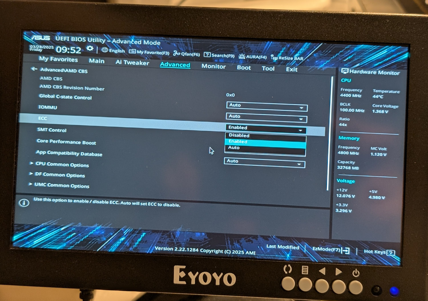

Just an update to this, the ProArt X870-E does have ECC support listed and has some ECC DIMMs in their QVL
Also in the Asus BIOS you need to enable ECC support since it’s disabled by default (“Auto” means disabled LOL)
