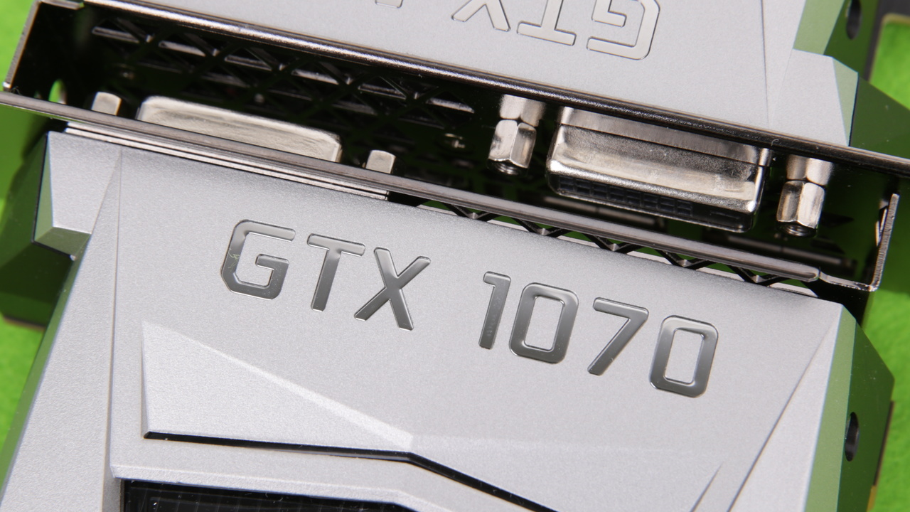

https://www.computerbase.de/2016-06/nvidia-geforce-gtx-1070-test/5/
https://www.computerbase.de/2016-06/nvidia-geforce-gtx-1070-test/5/#diagramm-xcom-2-1920-1080-intel-core-i5-2500k
Same site. different game
Here is a thought: Your ancient GTX670 bottlenecks your CPU in every game, all the time, today.
Get a card that fits NOW and stop worrying about what could happen next.
Seriously, the Sapphire Fury I linked for 350,- is one hell of a deal.
