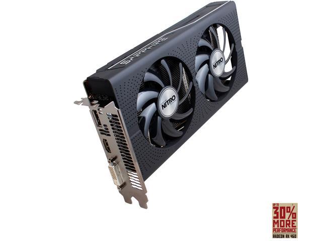

I'm just going to say it
RX460 is both faster and cheaper...
Example:
I might look into it but I heard that the Linux drivers are bad?
