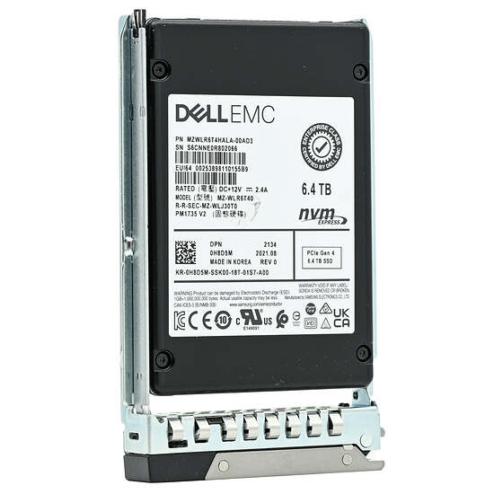

I would buy one or more large capacity U.2 drives (6.4/7.6tb or 15.36tb). You can buy lightly used refurbs for around $100/tb or less. I’ve bought a bunch of 15.36tb drives for $1,500 each from this vendor before, they currently don’t have any NVMe 15.36tb drives in stock buy here is a 6.4tb (3DPWD) drive for $100/tb:
