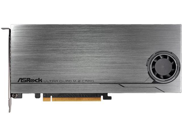

One of these drives is already close to bottlenecking the PCIe x4 lanes they use, so unless you raid them in a very specific way using add-in cards there won’t be much benefit.
And the sequential write speed on the 1TB drive is twice that of the 500GB one.
Depends on the way the slots are wired up.
One option would be something like this:
But I don´t know if that is bootable (probably is because X399 does not have that stupid raid key thing).
Well, given all of this, I guess I will just go with the 1tb drive then.
I will keep an eye on this and look into. I guess it could also work as a good upgrade later on, but I think I will mainly just use regular SSDs after getting the M.2 SSD or SSDs, and of course a 4tb or bigger HDD because I dont want to be low on storage.
