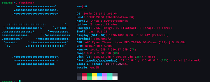

So I’m currently a Bachelor’s student in Comp Sci, and am (by a bunch of luck, I should say) heading an AI lab with a Threadripper 7995WX and a RTX A6000 (Ampere) in a Lenovo P8, with 256 Gigs of RAM.
Given this PC is, at most times, used by multiple researchers in our own rapid prototyping lab, we were considering upgrading to OR appending an RTX Pro 6000 as well - since some of our current workloads are VRAM limited (we work on industrial collaboration projects with super short timelines).
Would love to hear your thoughts!

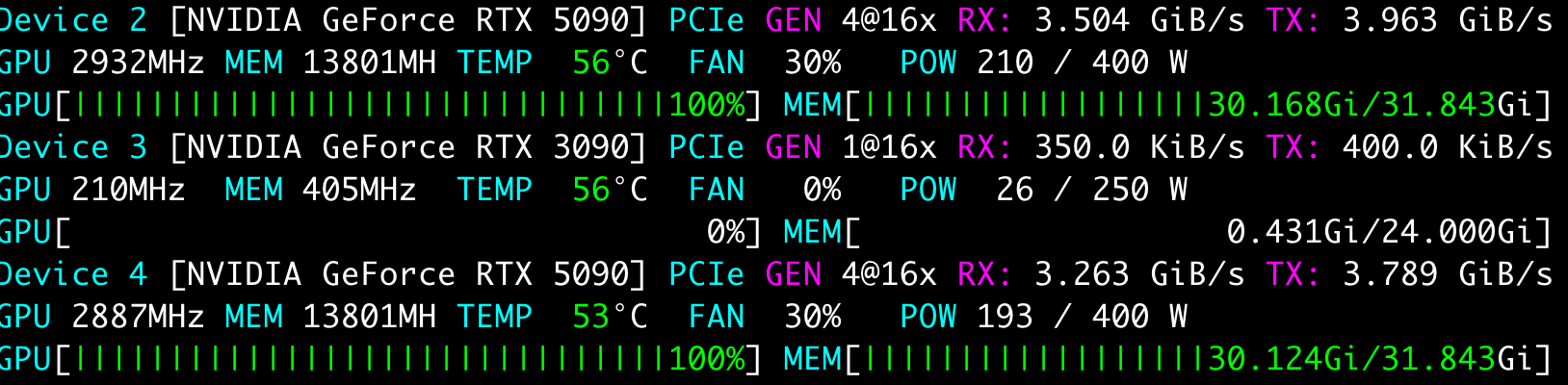

In my tests for inference I haven’t seen much TX/RX. For 1 request with vLLM 2x5090 (connected to pcie 4.0x16) using -tp 2 = it’s in the hundreds of MB/s, 200-300.
It peaks at 3-4GB/s for 10 parallel request though:
Test with this command:
VLLM_FLASH_ATTN_VERSION=2 CUDA_VISIBLE_DEVICES=2,4 python benchmarks/benchmark_latency.py \
                                                     --model /mnt/llms/models/mistralai/Mistral-Nemo-Instruct-2407 \
                                                     --tensor-parallel-size 2 \
                                                     --input-len 1024 --output-len 256 \
                                                     --batch-size 10 \
                                                     --n 1 --num-iters-warmup 0
vLLM installed from source with a custom pytorch 2.7.0 environment to support the 5090s

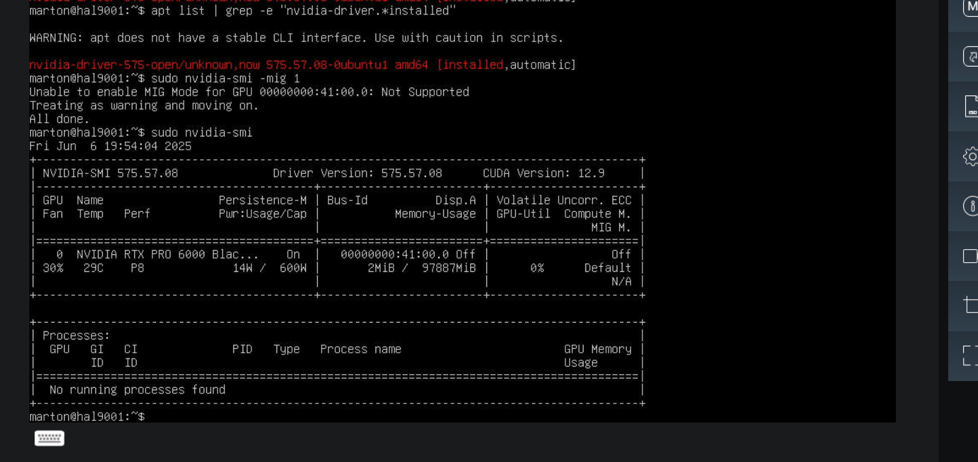

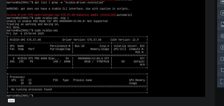

Ayo @wendell I don’t mean to beg but Nvidia support doesn’t exist for mortals - would you mind asking your contacts over there about MIG support if the opportunity arises?
Docs say it’s definitely a thing for Blackwell 6000.
It even spells out 575.51.03 as the minimum driver you need - which is what’s in the Nvidia Ubuntu apt repo right now, but that version definitely does not allow you to turn MIG on. There’s a newer .run driver (also doesn’t work), and it’s the same deal on Windows (576.something driver). Tried with 2 different 6000s on 3 different systems without luck.
575.57.08-0ubuntu1_amd64 is up at Index of /compute/cuda/repos/ubuntu2404/x86_64
Yeah thanks! That was the “newer run driver” I was referring to but was too lazy to check and quote exact version.
I did pull it from the repo just now to see if maybe they snuck in some last-minute changes before publishing it in the repo, but even if they did it’s not a fix for MIG:
fwiw, that command also doesn’t work on a secondary compute card either.
# nvidia-smi -mig 1 -i 1
Unable to enable MIG Mode for GPU 00000000:E1:00.0: Not Supported
Treating as warning and moving on.
All done.

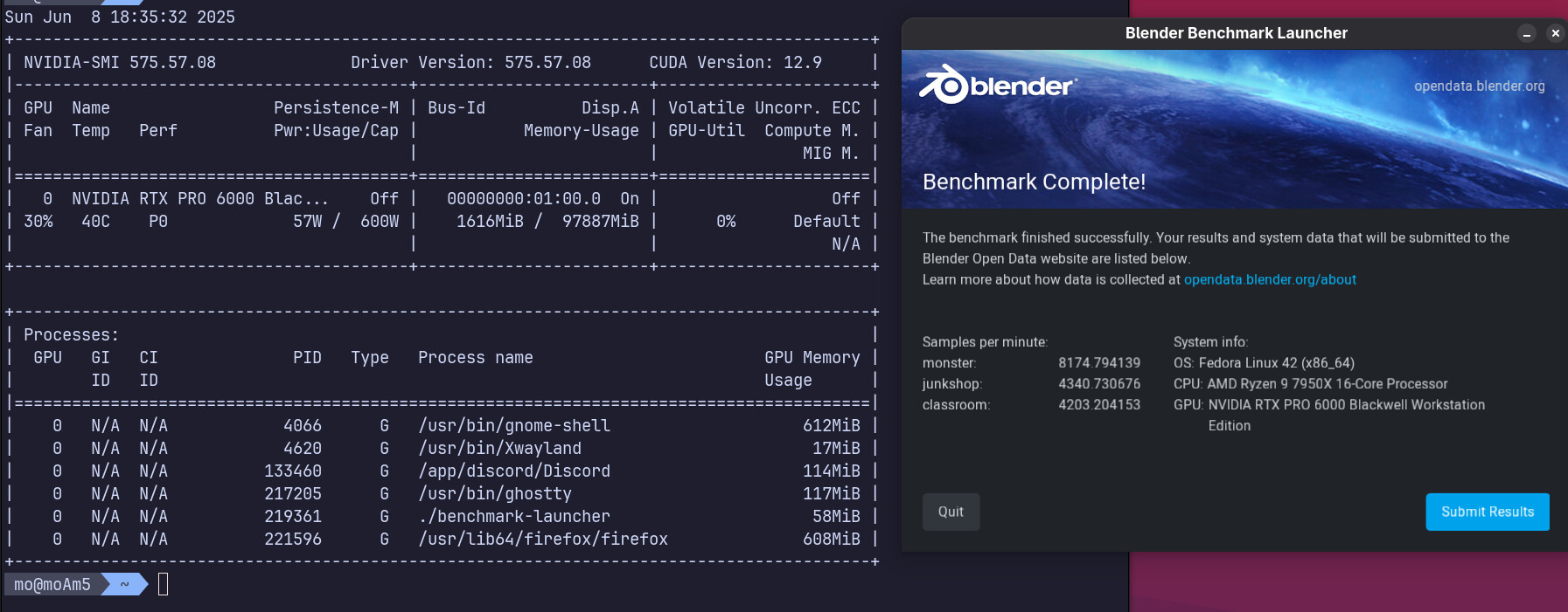

6000 blackwell
Ah okay, I thought you meant a datacenter card that’s compute-only. But no, just casually doubling up on the 6000s… Mind if I ask what PSU is powering that rig?
