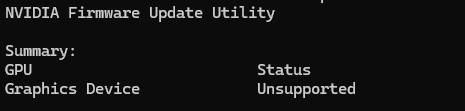

Anyone else have vBIOS 98.02.52.00.03 on the Workstation? I’ve tried RTXPro6000WSv9802810007 but I get the message that the device is unsupported for update
