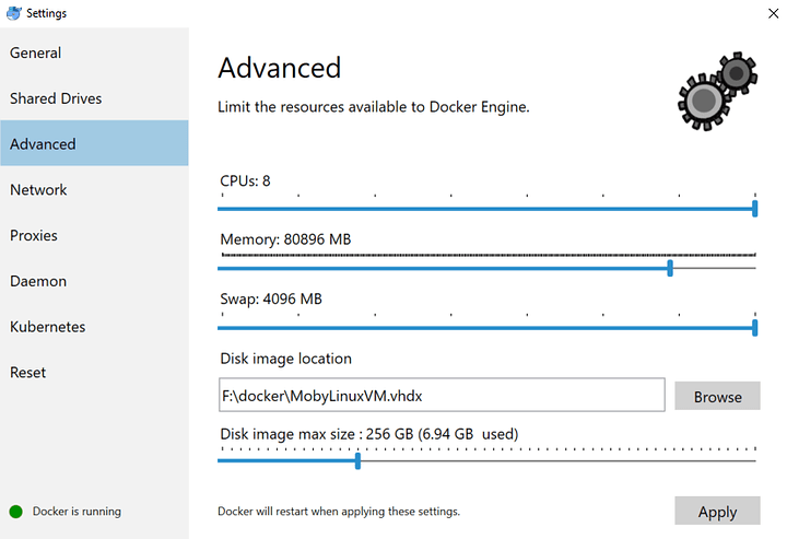

Can you confirm if you are using Docker for Windows on Windows 10 or if you have Windows Server 2019 installed and are using Windows Containers?
Could you also confirm if you are actually running Windows containers or Linux containers?
There are substantial differences between how the containers actually run so worth being clear on your setup and container types.
EDIT: The JPG below makes some of that clear :slight_smile:
yes I tried it, nothing after 32 GB have effect
I have Windows 10 Pro desktop, and I am using linux container

You might want to fire up Hyper-V manager and see how much mem is allocated to the MobyLinux VM.
32 GB :thinking: and I can not change it there

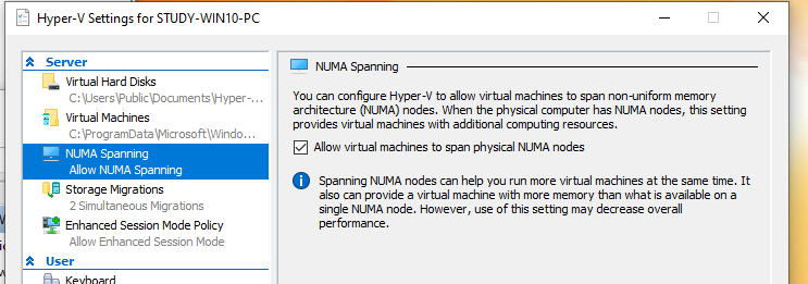

Check the NUMA spanning setting in Hyper-V manager:
Windows 10 Pro, and I have this setting also enabled obrazek
Sorry, I can’t see any obvious limitations on RAM that should prevent you allocating more than 32GB to a VM on that version of Windows. I’m on an older build and only have 32GB so can’t try a VM with anything larger, but Hyper-V will allow me to set it - even though I can’t run it.
You could try removing the NUMA spanning in Hyper-V to see if that helps. You could also try setting the VM to dynamic memory (it will start up with only 1024MB) and see how much is allocated once you start your containers up.
I can not edit memory settings while it is rinning, and docker change it back to 32 GB every time it starts it, stoping it manually changing it and starting it again cause it to be in permanent bootloop of 2 seconds uptime :frowning:
(setting it to less than 32 GB decreases the memory usage)
From what I can see Docker Desktop does like to manage the VM resources and uses a JSON config file to store the settings - so it will adjust the it’s VM to match when the service starts up. You can check the file here: ‘%APPDATA%\Docker\settings.json’
What version of Docker do you have installed? Your screenshot looks like the old logo I think. Definitely check for an update.
You should also be able to use the Troubleshooting options, see here for more details: https://docs.docker.com/docker-for-windows/troubleshoot/

thank you very much :slight_smile: I did not even think about possibility it can be some bug in docker, and I also did not think my version can be old :thinking:
I updated and it ask me to use WSL2, I said yes, the memory option disappeared from the UI, so I need to change it in the config file, but the app is now running and using 48 GB, in few hours I will know if 96 is enough or not :pray:
