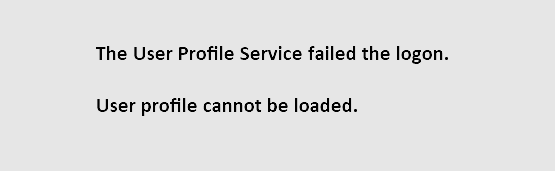

I am pretty sure I have corrupt local user on my main PC. There are programs that when I search for from start menu, and click on them, they don’t launch. If I scroll the start menu to find those programs and launch that way, they work. I also have couple of programs that refuse either to authenticate through their servers to let me log into them or launch all together.
Those issues are solved as soon as I log into another local user.

EDIT: I tried it and all that really changed was that when I tried to log back into my main user, it put me into temporary account since it couldn’t find the folder anymore. What was the reason to name my old user folder to old?
