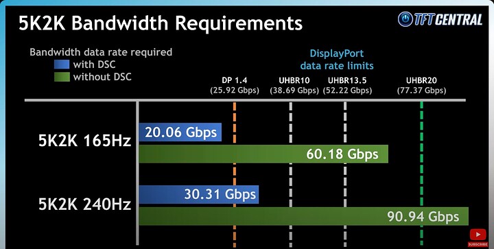

Will the DP 1.4 Combo KVM work with a DP 2.1 monitor so long as the data rate is below the DP1.4 spec?
KVM Model:
Combo USB-C + DP 1.4 KVM
Will the USB-C + DP 1.4 KVM work with the new 5K2K panels so long as the bandwidth is below the DP 1.4 spec cap?
Or would I be better off directly connecting both computers directly to the monitor and using a separate USB Switch?
Thank you.
Definitely go with a KM or our normal DisplayPort KVM.
