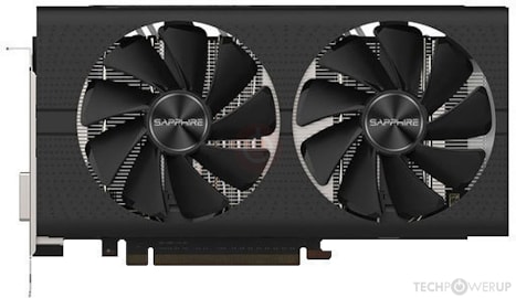

The first thing I noticed is your GPU.
I found this from Tom’s Hardware:
The 580 says it’s DP 1.4 “ready” so I’m assuming it should at least be compatible with a DP 1.4 KVM. However, I must add especially old AMD Linux drivers could be a little sketchy..
It could be that your VBIOS is old, and if the card is DP 1.4 ready, maybe they fleshed that out in more recent VBIOS.
i would check if there is an actual VBIOS update for your Radeon RX 580. (NOT graphics driver) The latest I could find from Sapphire is 2018:
