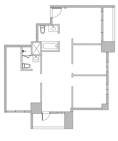

Physical Situation: A single level apartment of around 100 m2 in area, walls are drywall.
Wishes: I would like full 6Ghz coverage in all living spaces (indoors except bathrooms) and 5Ghz everywhere else.
This is the blank floor plan. The main door (top left) is 1.05m wide and can be used as a size reference.

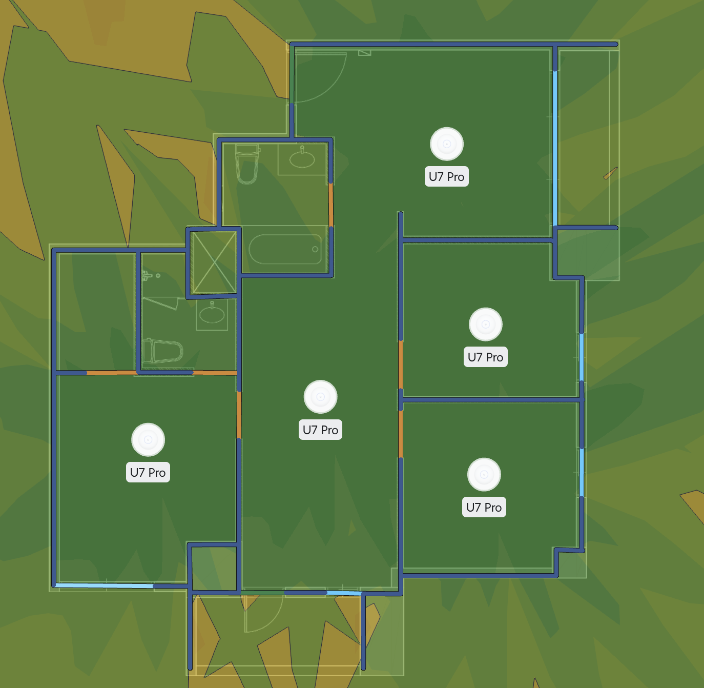

This is what I currently have on the Unifi planner and this heat map is showing 6Ghz coverage. I feel like I have too many APs?

So if you only have two channels without overlapping when using 320MHz then you should cut your number of APs down to four and use 160MHz channels. Your house is too small to do overlapping channels. Looks like APs are not even 10m away from each other.
For my 900m2 house with three stories 2 u6 enterprise APs serve the entire house just fine. 1940s build with a mixture of wall materials and a not very open floor plan. The unifi planner wants a much higher gain than many devices need or want as well. You can always add more once you have the central AP installed and have seen the real world performance in your space.

You definitely don’t need four APs for that size apartment since about two well-placed units should easily provide full 6 GHz coverage through drywall, with one positioned in the central living space and the other covering the right-side rooms. Too many APs only add co-channel interference, so it’s better to reduce the count and tune settings carefully. Band steering should be enabled so that capable devices prefer 6 GHz first, then 5 GHz, and finally 2.4 GHz. For transmit power, run 6 GHz on high, 5 GHz on medium or low, and 2.4 GHz on low, which keeps overlap to a minimum. On channels, 6 GHz is best set to 160 MHz since the locally available 5945 to 6425 MHz band cannot fit two non-overlapping 320 MHz channels, and overlapping them only causes more problems, while 160 MHz gives you clean usable channels. For 5 GHz, stick to 80 MHz maximum and enable DFS channels, which in practice are less congested and only rarely force a channel change if radar is detected (if you live in a city or near a weather radar or near an airport), something unlikely in a typical residential environment. Keep 2.4 GHz at 20 MHz only. This combination provides wide, consistent coverage and limits interference both inside your network and with neighbors. If your goal is consistent performance everywhere, use only 160 MHz on 6 GHz, but if you want absolute peak Wi-Fi 7 speeds in one space you could set a single AP at 320 MHz and testing if you need another?
