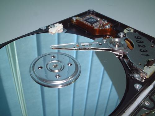

Every HDD does this, or else you would not be able to use any HDD at all.
The problem with spin-downs is not the head touching the platter, it’s the wear and tear on the bearing when constantly spinning up and down.
Also when you’re referring to a video, you should also mention the video so people actually have context…
The feature is called “head parking”.
