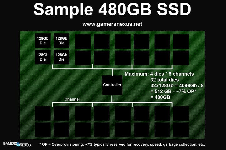

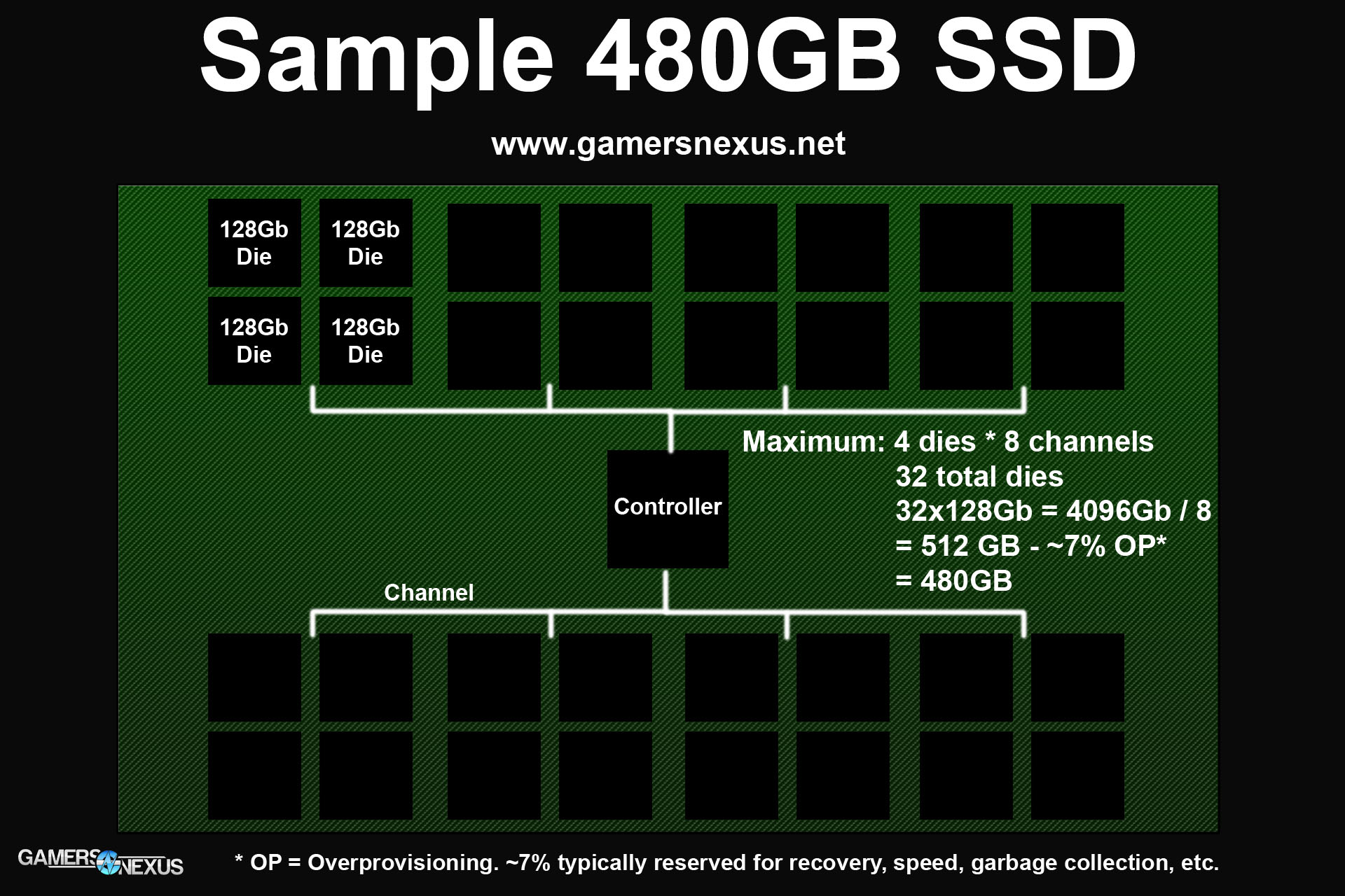

GamersNexus actually has an article on How SSDs Work, published in 2014, but the general structure and architecture really hasn’t fundamentally changed how it works.
In his example, he is referencing the “Micron’s 16nm, 128Gb Flash in this example.”
4 GB in bits is ~ 32 Gib.
That means that each time you write ~4 GB of random data to it, you’re writing about 32 Gib of data.
The example that GamersNexus cites also is a dual plane SSD, and each plane contains 1024 blocks and each block contains 512- 16kiB pages.
As he also notes, in this example, the SSD can only write the data in 16 kiB pages (and it can move them around, with wear levelling).
Rounding up to 4 GiB, divided by 16384 byte pages, that would be 262144 pages.
If a sector is 4 kiB and a page is 16 kiB, therefore; one page = 4 sectors.
If one block is 512-16 kiB pages, then therefore; one block is also equal to 512 * 4 sectors = 2048 sectors/block.
There are 1024 blocks/plane in the example that GamersNexus is using, therefore; 2048 sectors/block * 1024 blocks/plane = 2097152 sectors/plane.
It’s a dual plane SSD, in GamersNexus’ example, therefore; it would be 4194304 sectors/128 Gb module.
The 480 GB drive in the example itself has 32 dies, and therefore; 4194304 sectors/module * 32 modules = 134217728 sectors.
Since we had previously calculated the number of sectors that would be written to write 4 GB every 5 minutes, daily = 301968000 sectors written/day, therefore; if you divide that by 134217728 sectors, you’re getting around 2.25 DWPD (if you’re using this 480 GB example that GamersNexus is using).
Even if you gave it the referenced 3000 program/erase cycles per NAND flash module as its rated write endurance limit, you’re programming/re-programming/erasing/re-erasing the drive over twice a day.
Therefore; 3000 P/E cycles / 2.25 DWPD = 1333.333 days of life. Divide by 365 days/year and you’re looking at about 3.65 years.
And that’s JUST with writing 4 GB every 5 minutes, or about 14.3 MB/s, which is a tiny fraction compared to what the rated spec is, even for random I/O.

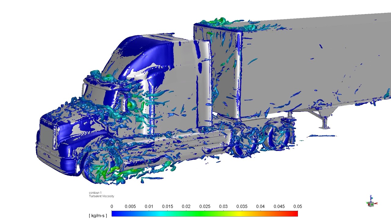

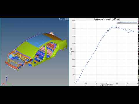

When I used to run the aerodynamics CFD on the model of the semi (shown above), each time I ran that model for 2 seconds of simulation time (which took, I think the fastest I ever got that to run, was about a week with 64 CPU cores), writes out about 5.1 TB of data.

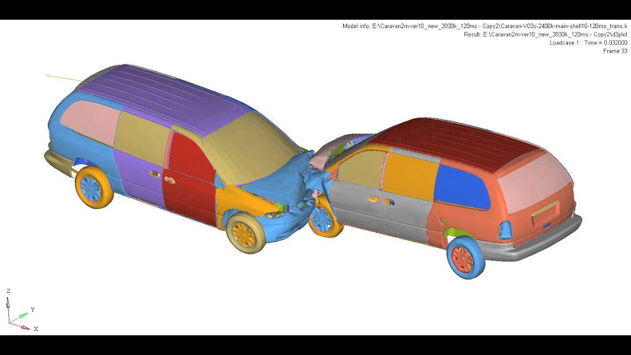

For the stuff we run at work, some of our thermal models now uses 1920 CPU cores and it runs for 20 days straight (or thereabouts) and this is why, we even have HPC nodes with 4 TB of RAM now, in our HPC cluster, because prior to that, after the runs were done, we couldn’t post-process the CFD results, because when we tried to load the results in, the node would crash. (Even with 4 TB of RAM, we’ve gotten the 4 TB RAM nodes to crash as well.)
You wanna see people beat the crap out of computers? Talk to an engineering team.
One of the guys that works at SpaceX that I know from college, one of his Monte Carlo sims will eat up 2% of the write endurance limit from a E1.S EDSFF SSD. And he has to run it over and over again, for whatever problem he’s working on solving. My dad wanted me to get into computers. I went into engineering instead. After graduating, I told him that as an engineer, we will never have “too much” computing power/resources. We’ll just keep making our simulation models more and more detailed and we’ll suck up any and all available compute power you give us.))

It is very dependent on the size of the problem that I am trying to solve.
I think that the last model that I was running only had something like maybe 563k elements, but FEA solvers, generally, are linear algebra matrix solvers, and as such, they usually/generally work best when they can run the entire solve process, from RAM.
(But of course, with that, the system then “freaks out” and think that I’m about to run out of memory, and so it starts swapping stuff out because swap doesn’t know (and probably doesn’t care) that the memory load is temporary.)
And then when it can’t swap out, it sees the solver processes as the high memory consumers, and kills them off, as “OOM” errors. Something like that. (I haven’t studied it in depth, I just know/see it happen via top, where the solver processes would go from running to pulling off a disappearing trick.)

NAND FLASH REALLY doesn’t like changing a bits in the sector - ti has to rewrite the sector entirely.
And when writing it into new place, it can only write 0s over 1s - so it has to write over empty sector.
And it can erase only block of sectors.
So it’s easy to see how even small writes can be destructive and cause a whole lot of re/writing, erasing etc etc if done in FLASH unfriendly manner.
Controllers do their best to alleviate the problem, but their resources and possibilities are limited.
So F2FS+file compression might just solve the problem.
On second thought, I’d skip ZSWAP etc because they are workaround graft/kludge that in the end don’t compress evicted pages on the disk-only in RAM.
Allegedly it also helps to partition the drive so that you leave some space free at the end (unpartitioned space). Controller should be able to recognize that and use that space as a spare for defective sectors replacement.
People recomment 7-20ish% as optimal.

So it would, on the surface, look like an extra layer of overprovisioning for wear levelling, basically, above and beyond what the drive already has for said overprovisioning for wear levelling?
