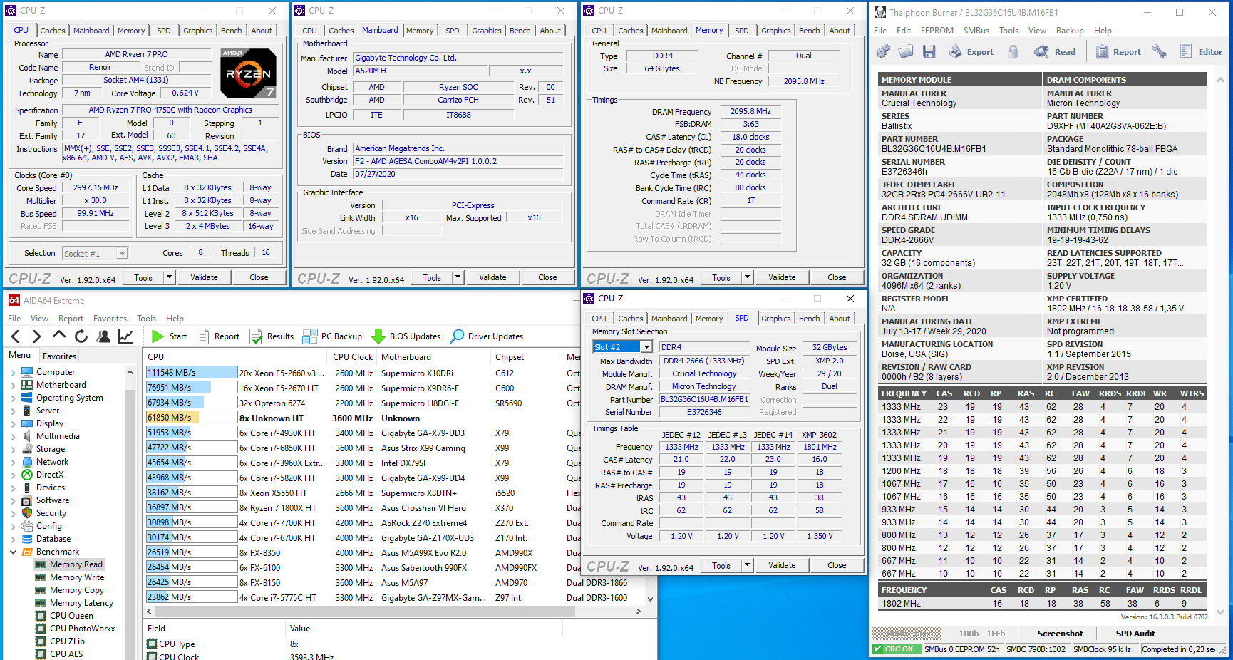

Just found someone in a German forum posting some promising (?) results: https://www.hardwareluxx.de/community/attachments/ram2-png.529996/
I’m using 2x32GB of the Samsung M391A4G43MB1-CTD in my NAS on a B550 Steel Legend with the 3600. I can see how stable they are running at 3200 on stock voltage and timings, if you like? Seen a couple of people running them like that without issue.
If you feel like it I’d be interested. Though I do plan to run these modules at 3200 minimum, preferably 3600+. Your modules I initially dismissed because this seems to be quite a big overclock. But now I see buildzoid got your kit (without ECC) to 3600 / CL17
If you can achieve the same that would indicate some consistency in overclocking potential which is all I’m looking for at this point.
