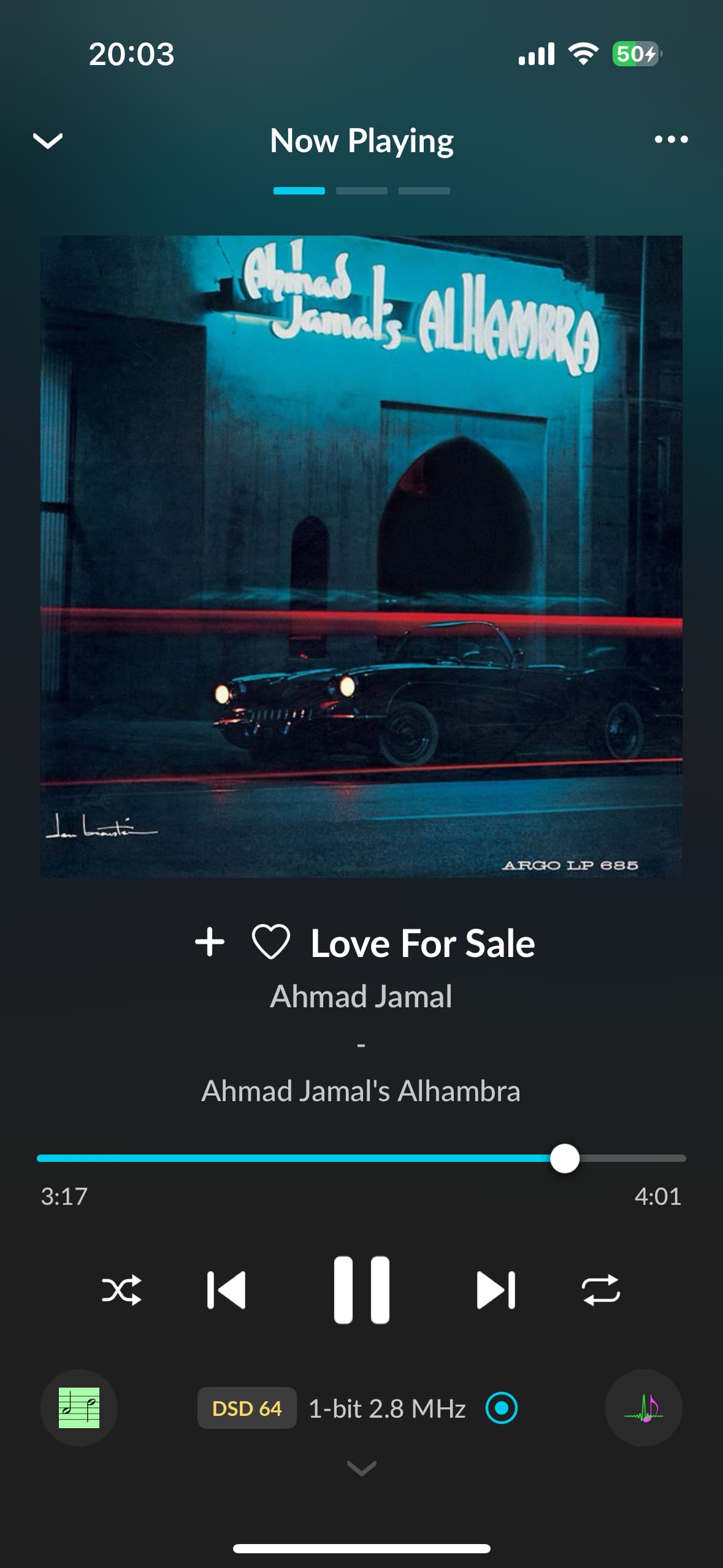

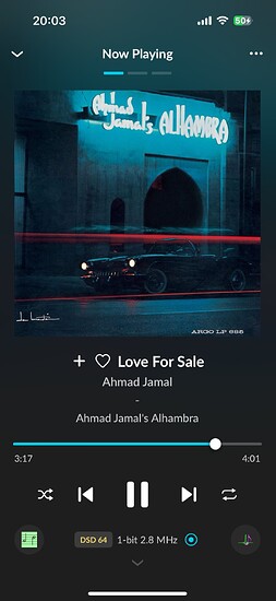

In the meantime, I am going to listen to a vinyl album, recorded in DSD and downloaded years ago from the sorely missed Acoustic Sounds download store.
