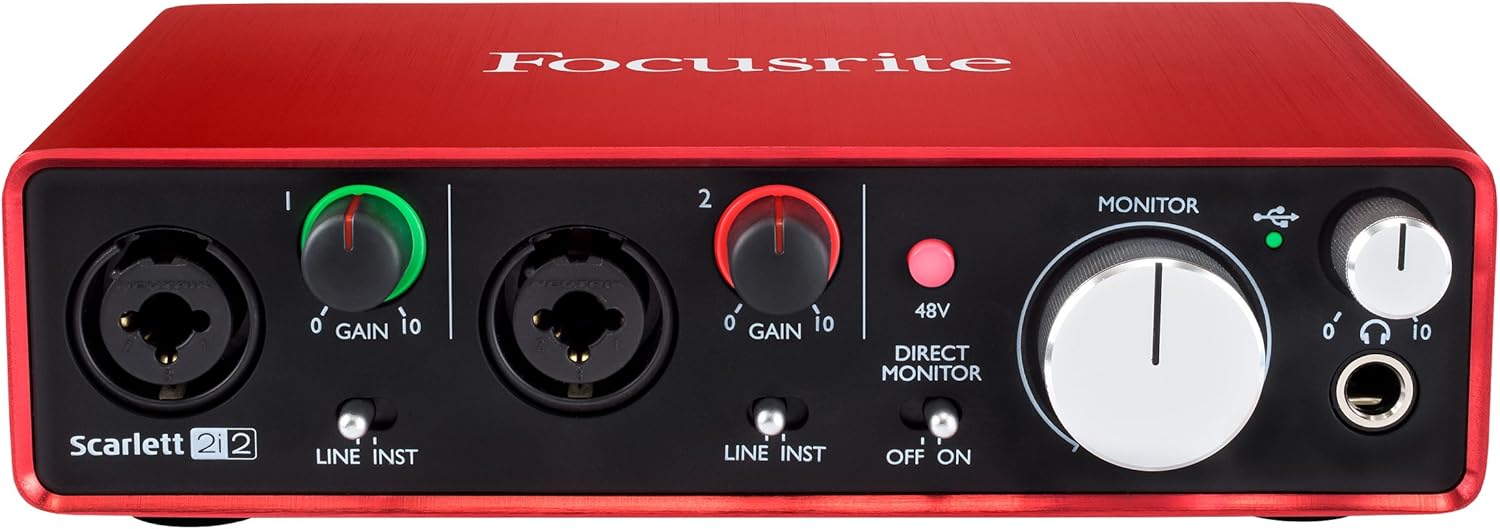

Having said that, the output on the Scarlett 2i2 is balanced according to Focusrite's website. You're still paying for more than just a DAC, but it's quite a bit cheaper. Apparently uses a Cirrus CS4272, which looks like a half decent DAC.

also the Scalet doesn't have balanced outputs on it from the pictures on amazon.

The outputs on the back of the unit are balanced TRS according to the tech specs on Focusrite's website.
