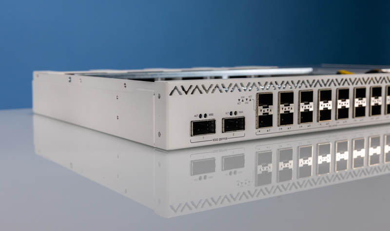

CRS518-16XS-2XQ-RM form Mikrotik could be a possibility
Servethehome has a video with more details …
Not insanely expensive for what it is. No hands-on experience with it on my end, so :salt:

Also - what is the difference in quality/reliability/throughput of QNAP vs Mikrotik? I’ve never worked with Mikrotik products in any companies, nor datacenter. Have only worked with two QNAP switches.
I like that the Mikrotik switch has dual power supplies. Unless I’m mistaken, I was under the impression that Mikrotik was a budget line of products? (I know the QNAP is evidently budget-level.)
I mean, in a TOR-role, QSFP can just break out to 4x SFP :slight_smile:
They are both not Cisco/Juniper/Arista/Aruba, but definetly “good enough”-tier.
They are budget tier, which shows in strange ways.
For example they have a lot of features available, but you need to pay attention to which of them get moved off of the switch chip and into the sometimes underwhelming CPUs.
So L2/L2+ may be fine, and L3-doings then murder performance.
I would put them in the SMB tier, budget tier for me are the el-cheapo Aliexpress ones…
I don’t count them at all :neutral_face:

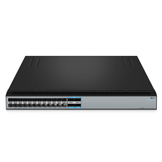

MT CRS518-XS16 vs FS S5850-24B4C
16x 25G + 2x 100G = 1600€
24x 25G + 4x 100G = 3700€
