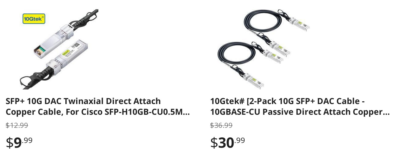

10GTek also makes directly attached copper cables (with the transceivers permanently attached). These are really great for short runs while still getting the speed of Fiber, and might be what you’re looking for.
(photo from NewEgg, but you can find them lots of places)

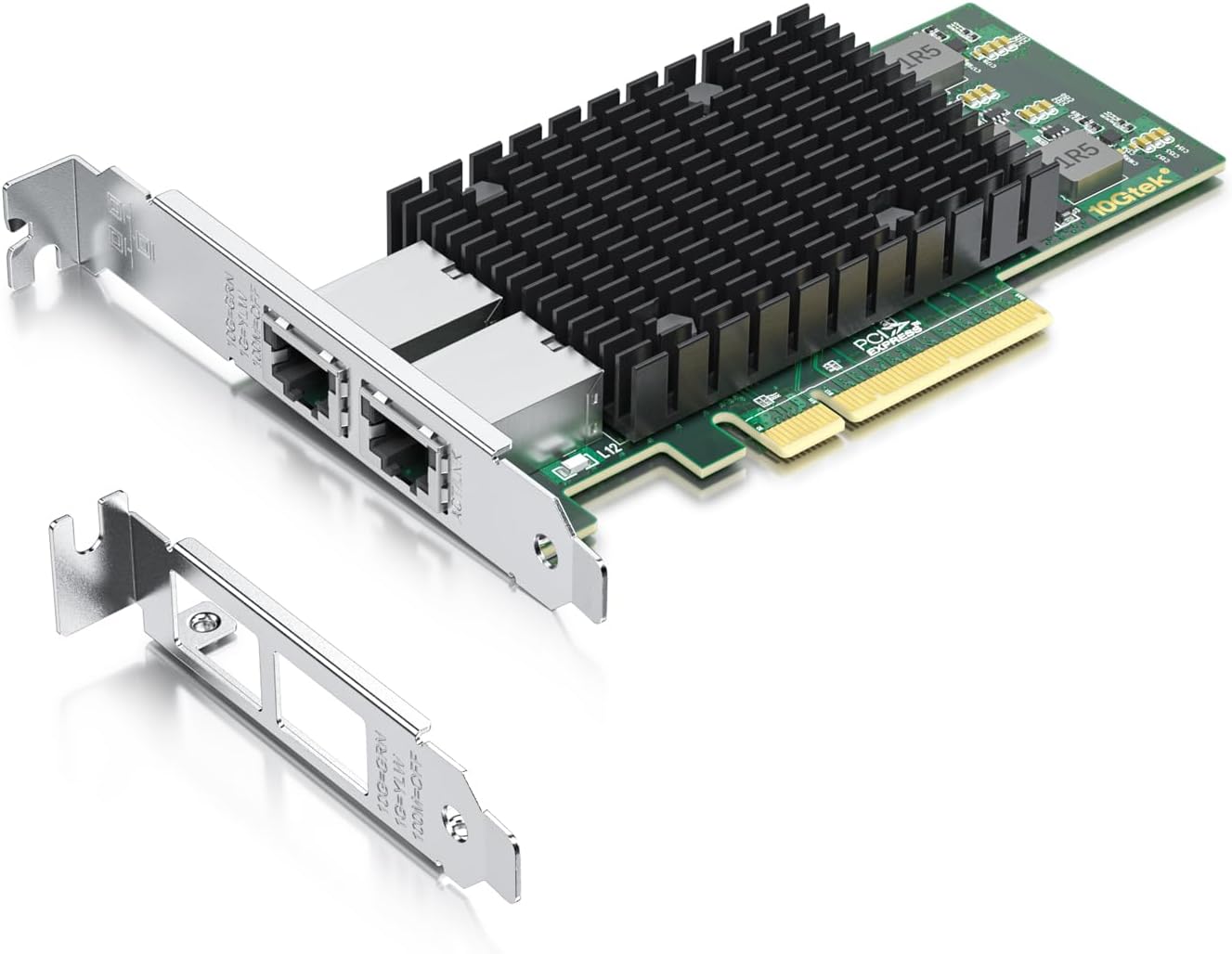

I am looking for a card that can fit in a small form factor system. I need the card to have two ports but the two port devices all seem to be to big. I need a half sized bracket with a card that isn’t to big. I don’t necessarily need SPF+ but from my research there isn’t much of a cost difference.
Any ideas for a card that can fit in a small system?
I run this on my TrueNAS server. It comes with the 1/2 hight plate.

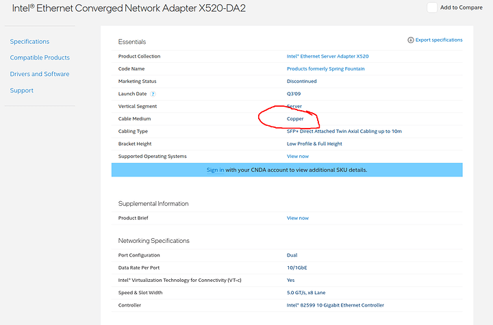

OK so I am confused are you wanting a SFP+ port with a RJ-45 module or a NIC with a RJ-45 port?
X520-DA2 supports both, SFP+ and RJ45 (says SFP right under your circle :wink: ), just depends on who designed the board and connectors around the chip.

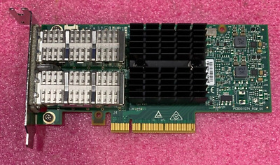

In any case, the cheapest option you have for direct-connect networking in proxmox at 10Gbit or above is old infiniband cards:
These run 20USD apiece
cables should be 10-20USD depending on length, you do want to keep servers at 3meters or less from each other, 5 meters max …
