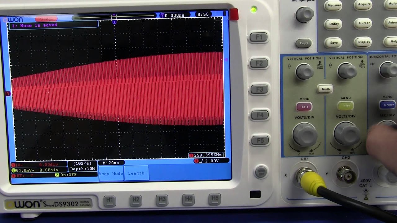

No idea how good this is. The other stuff Rigol makes is great tho.

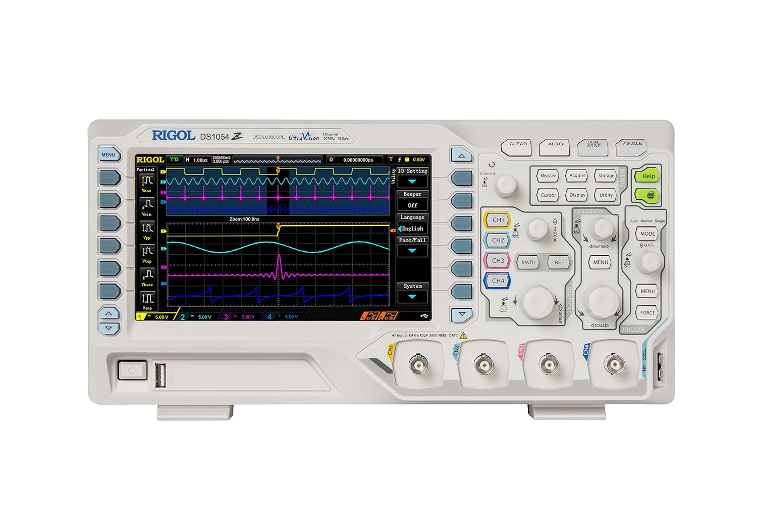

I got a Rigol DS1074Z-S myself and it is a very usable scope for the price. The DS1054Z is similar, a little less bandwidth and no built in signal/arb generator but much cheaper.

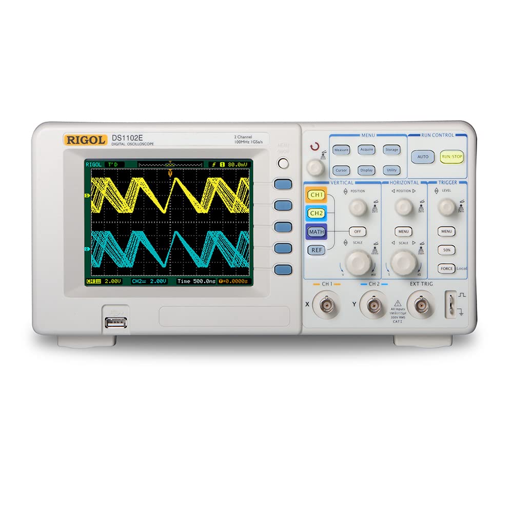

The DS1052E/DS1102E were hugely popular a few years ago. They practically have been replaced by the DS1054Z because that model is better in almost every way. Both scopes enjoy their success because both can be "upgraded" (coughs) to their higher model ones. This made them popular because people would buy the 50MHz model and acquire the 100MHz via this "update".
In fairness, both Rigol scopes are surprisingly good value anyway and their build quality seems very reasonable. Of course a Tektronix or Agilent will be even nicer, but their comparable feature set scopes will probably cost 4-5x as much.
I understand budget constraints, but if you can I would get the Rigol 1054Z. It's intensity graded display is an absolute pleasure for any AC signal. However I use my oscilloscope mainly for development and debug for my own boards, and so probably will value the more advanced features (e.g. serial decoding, advanced triggers, more memory, etc.) much more than is worth for repair work.
The E-series scope will probably get the job done as well and won't fall apart after 5 years time, but it's not the best bang/buck anymore today.
