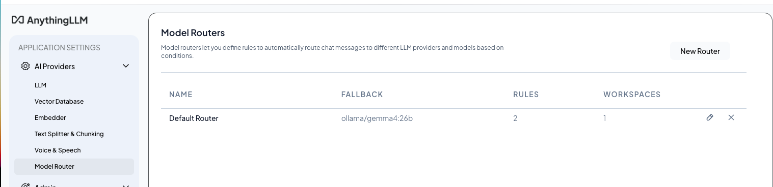

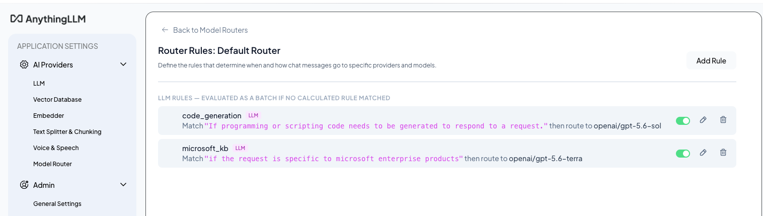

Anything LLM has an inbuilt model router.
So you can do things like:
  • Use gemma4 12b for basic chat / things like drafting documents
  • use gemma4 26b for research projects
  • kick off to say, GPT sol for complicated things
using either basic rules or LLM interpretation, e.g.
Anything LLM can use multiple different LLMs within the same chat to complete requests, depending on whatever rules you make above, or by manually changing the model mid-chat.
