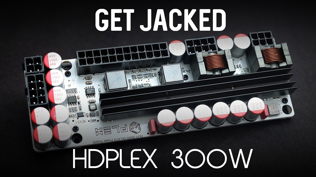

What are your thoughts on this mini 300w PSU
HDPLEX 300W Hi-Fi DC-ATX Power Supply (Wide 16V-24V DC Input)

Im confused does it mount in a pc or is this for kit building other electronics?
They are usually used in small fanless cases for HTPCs/small client machines and for anything that needs a tiny fanless PSU.
Not meant for a PC. Meant to output power for desktop-grade hardware in a much smaller package (using an external PSU).
I can't give any first hand opinions on it yet because the build STILL hasn't happened. I will say the build quality appears to be top notch.

just found this, this guy seams to think you can run a full fleged pc off it
It's literally just a DC-DC converter, so you'd need an external power supply to run it.
