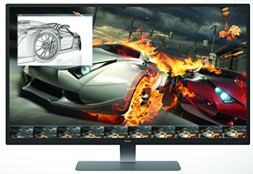

Westinghouse WE40UX8310 40" UHD Monitor Info
Curious if anyone has looked into this monitor. It's marketed and warrantied in the USA, but seems to use similar panel and setup to others discussed here from Korea...but has a more proper monitor stand and USB and Audio stuff. And only $600 shipped prime from Amazon. It's only real weakness I can gather is it may be PWM, but I think some of the other Korean are also, even though they claim not. And it seems to not have PiP sorta stuff like most of the Korean ones.
It's basically the exact same monitor as this more spendy Seiki Pro. The Seiki just has the PiP features...but seems identical otherwise.

This monitor looks to be the exact same as the Seiki 40" Pro monitor. Could be a decent buy at this price.
Yeah...it seems so. You get a more "monitor" style stand than the Korean ones...and a USB hub. And only lose the Multi input Picture in Picture and Picture by Picture stuff of the koreans and the Seiki Pro it seems. Think the processing and controller board not needing to output more than 1 input at a time is the reason this Westinghouse is sold at a much lower price. But somewhat curious if the image processing and ability to calibrate colors matches the Seiki Pro and Koreans also since it's so much cheaper. The Seiki Pro at least has one review linked above and it looks great and I'm leaning toward this Westinghouse on the similarity....would just like to see some info from someone other than Amazon reviewers on how decent it is and whether it uses the same panel as the Seiki or not since it also seems there are a few of the VA panels getting used even in similar models that aren't all as nice as others as far as Pixel arrangements and such.
