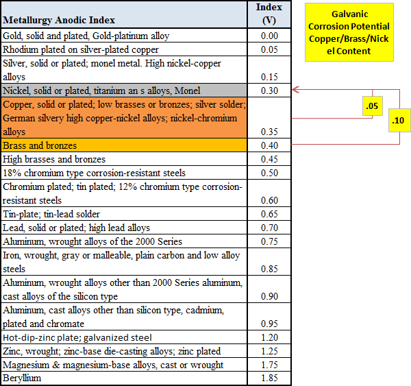

To expound on this with even more materials science, galvanic reactions occur because of the dissimilarity between metals. Passersby can make use of this nice chart, keeping in mind that in the controlled conditions of a water cooling system a difference of about 0.30V on the anodic index is acceptable.

OP Note how the aluminum is a mile away from common loop metals .. Always avoid aluminum.
You guys rock. Roger! I'll avoid aluminum like the plague.
