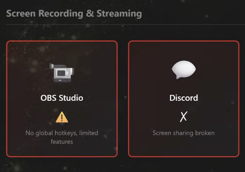

Here is an image from one, just to show I am not straw manning someone making up claims.

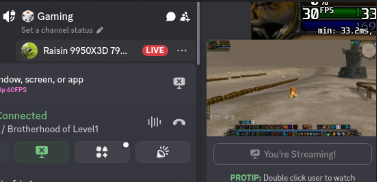

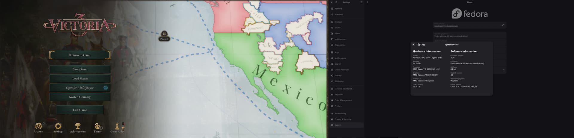

Now here was me screensharing on the Discord, I am screensharing an exclusive fullscreen application using just Wayland, no xwayland involved here at all.

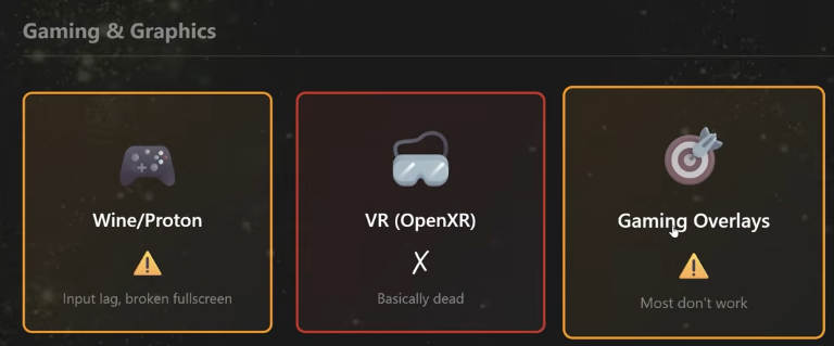

Here is full screen Victoria 3, running in windows fullscreen using xwayland still.

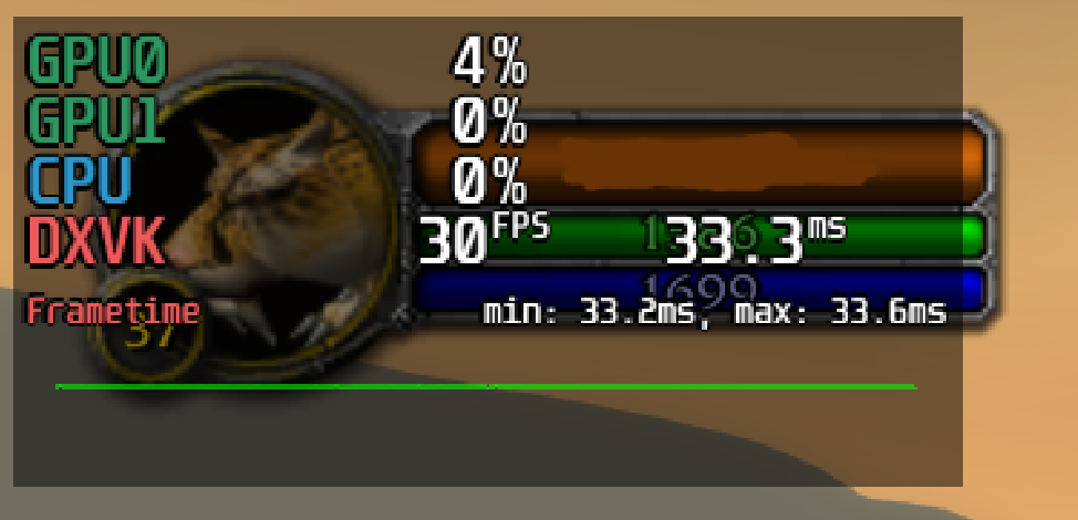

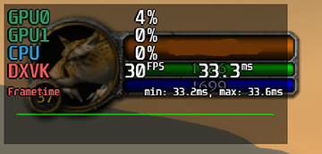

Mangohud works including the frame limiter. Also if these overlays didn’t work they wouldn’t work on SteamOS, as gamescope is a wayland compositor, but maybe the authors mean it does not work with Wayland clients, but I am running Wow with Wine running using Wayland.

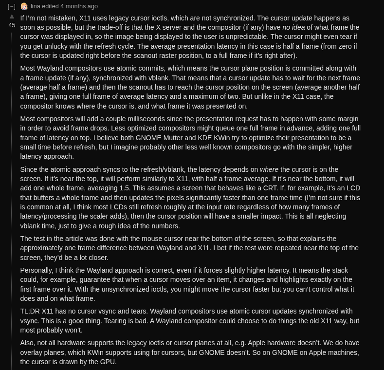

Ok this input latency bit took up a ton of room in this post. so here is a TLDR: Wayland forces cursor updates to be in sync with the rest of the frame, xorg does not and shaves of 1 frame of latency in some situations, but probably does not matter in video games. This is not input lag in terms of when the video game gets told your mouse moved.
Ok what about input lag, well this is complicated and gets into a few topics I am a bit more shaky in my understanding of all the situations. So I assume they are referring to this article which found Wayland adds 1 extra frame of latency in its testing.
https://mort.coffee/home/wayland-input-latency/
I assumed this is just a bit of vsync latency and it depends where the mouse move lands and this is kind of true based on what I read but not fully. Wayland has forced vsync by default which I think is great.
Lina here has worked on graphics drivers for the Linux kernel.
As far as i know all LCDs still update row by row to some degree and don’t buffer the whole frame otherwise screen tearing wouldn’t exist, so the impact of different latency at the bottom vs the top of the screen probably does matter. So it is not exactly vsync as I think the cursor in X would bypass vsync so that is why i think my understanding is not fully right.
So chances are the latency would be lower near the top of the screen. I only have a 240fps capable camera and chances of having some kind of hard to decider situations due to the lack of global shutter seems possible, but also thinking of what impacts the readout speed would have too as my Nikon has a pretty slow speed.
The other thing is I don’t think this actually means input lag in say a video game where people would care about an extra frame of latency that is possible. As this is not latency in input to the application, or in the speed of how long it takes the video game to output to the screen, it is purely a issue of the cursor. So i don’t think would say delay inputs to Battlefield, but the overall vsync could, but Wayland has a tearing mode these days for people who want that.
For me I always just run vsync anyway in my games to use it to cap framerates.
Gamescope I also think has a true direct mode, as far as I know GNOME does not have true exclusive fullscreen where things are handed off, the compositor is always responsible.
Apparently this is maybe how Windows also works now.
“With the release of Windows 10, we added Fullscreen Optimizations – which takes full screen exclusive games and runs them instead in a highly optimized borderless windowed format that takes up the entire screen.”
Also VR might be broken on wayland i don’t know I don’t know anyone with a VR headset to test this.

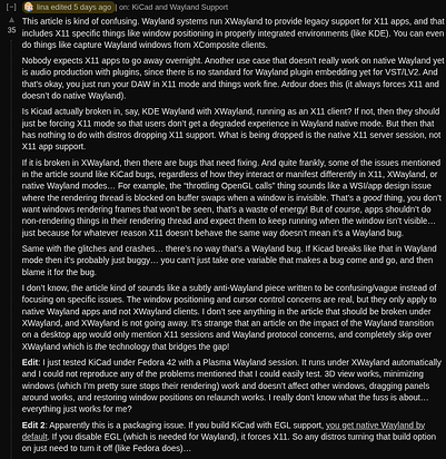

While I’m not neck deep into using it right now, KiCad’s development team recently came out saying Wayland was feature poor and kind of buggy which results in their application not running well on it.

Edit: I wanted to add this post from Simor Ser who works on Wayland a lot of the stuff taking time is just a lack of volunteers and they do their best to implement this stuff but they do want to do it correctly not force out a hacky solution and call it good enough.

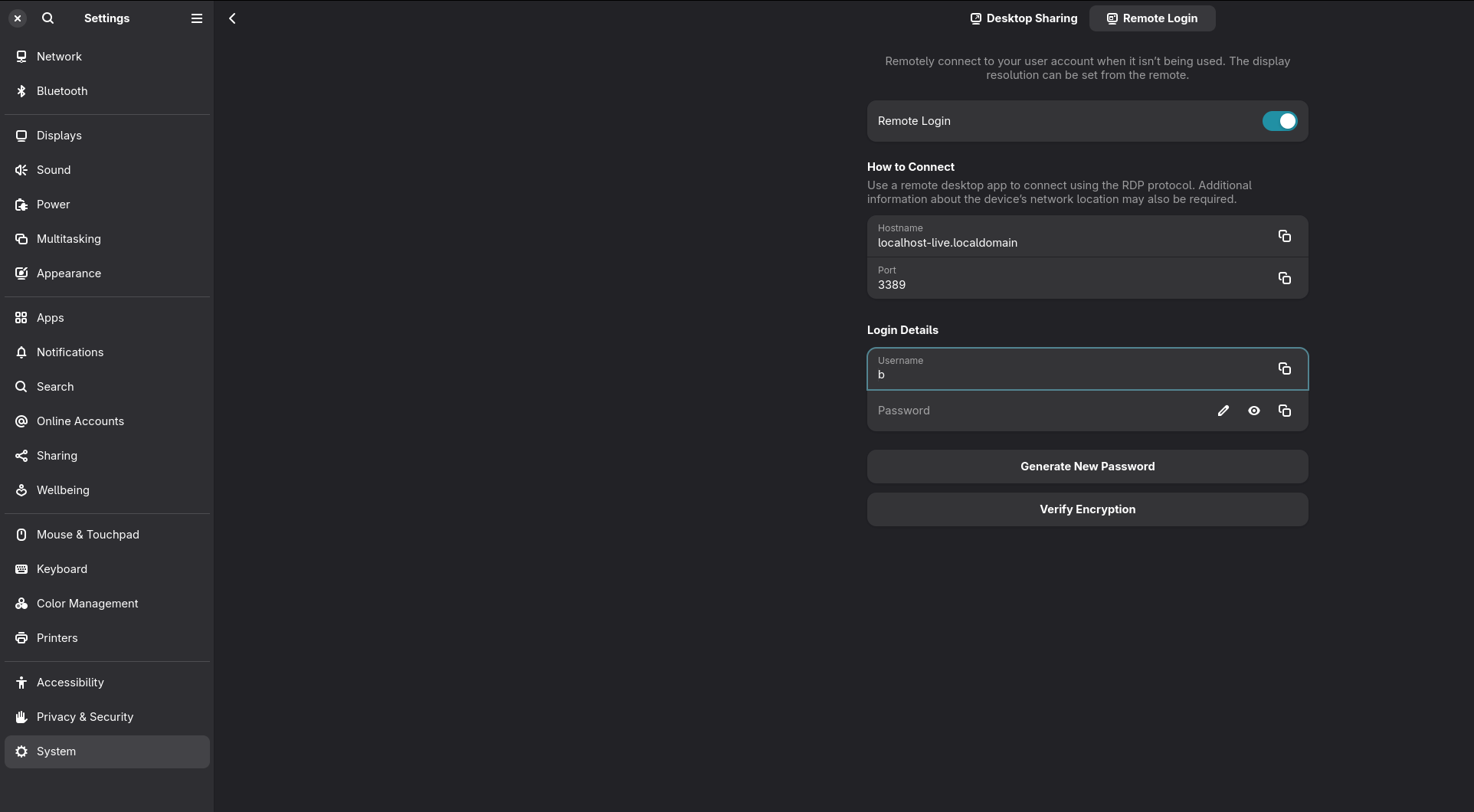

I have never run a RDP server on top of Linux at least that was accessing the desktop we do run Guacamole on RHEL at work, but it is for accessing windows servers.
But i just went into the remote settings in my settings and just connected from my laptop and that works I obviously can’t say how nice it is long term, but it seemed to work as well as I would expect an RDP connection to Windows to work.

Browser Docks don’t work and won’t for the foreseeable future.
Screen capture (window and monitor) is hit or miss depending on the DE and Distro (which in all fairness is not a “wayland issue”, they’re just behind on implementation).
Even on DEs and Distros where Screen Capture does work, it can be annoying to deal with as restore tokens for the capture are wonky at best and very much depend on how the DE implements them (if at all).
As for the Discord “screenshare broken” that was true until maybe a month ago when Discord finally updated their Electron from the stone ages.
That video was from the last week, and i didn’t say everything was FUD just that there is. Yes some of what kicad wants is not in wayland or is only just added.

I did lots of discord screenshares over the last few years just without audio which was broken under x as well that was a Discord problem in general.
I shared Cities Skylines 2 on Discord with friends when it came out in 2023 and I have only ran Wayland since 2018. Like it is something that has worked just the audio was broken on all Linux.

Screensharing seems to work quite nicely for me in Discord…
