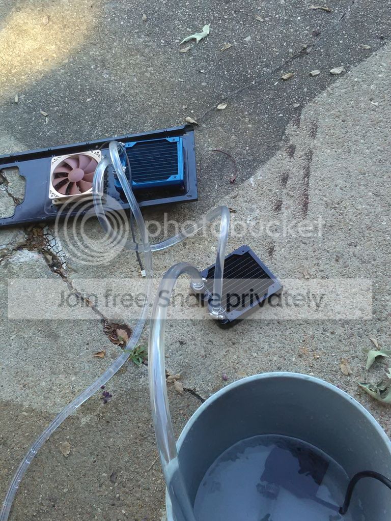

so i am finally getting my final piece (water block) for my budget water loop. currently i have 2 120 MM radiators from danger den prepared and ready to use. a 5 gallon paint bucket res and a garden fountain pump. current total spent is $75
first test assembly of pump and radiators checking for leaks in rads that were freebies.
spacing for my 240MM rad is a no go with this top
more to come after i get the block in and finalize tube length. and radiator placement.

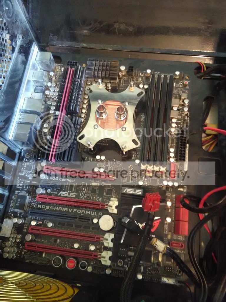

installing block
re doing all the cable management

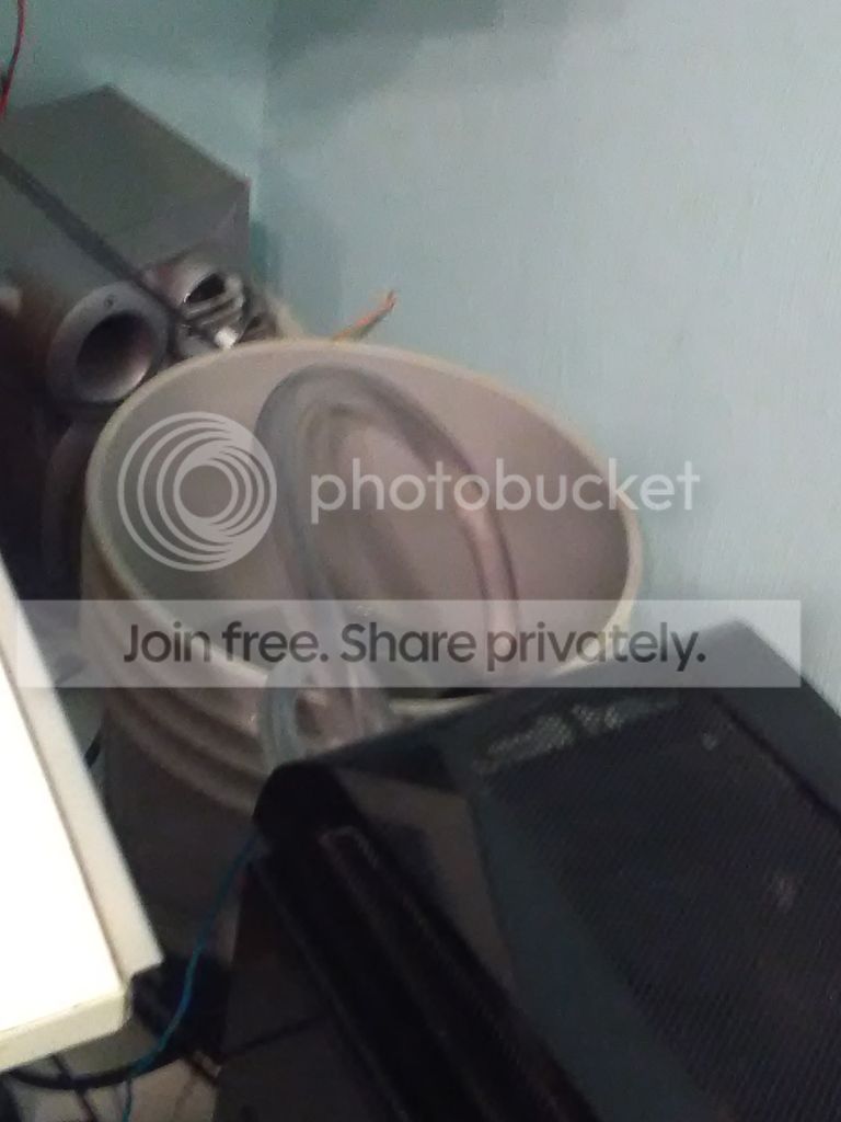

overall im super happy. took hours and hours but was well worth the time.
for those who were curious yes its still a 5 gallon bucket res.
