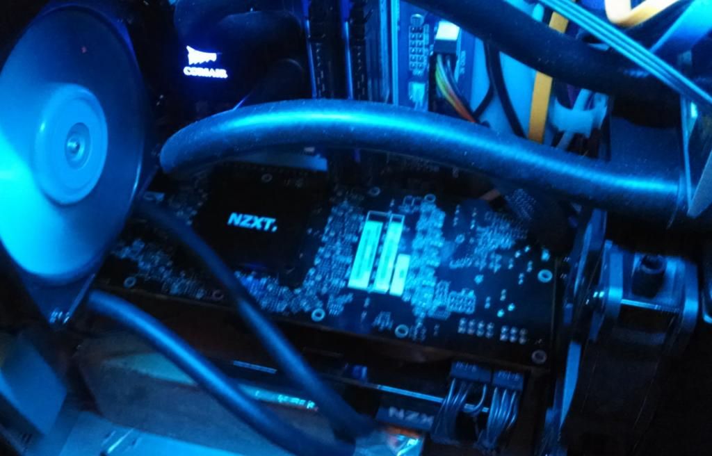

Well i broke down and installed the g10 anyway ( still waiting on my heats for the vram) Dropped my temps on my 7870 down to 47 to 49 degrees under Heaven benchmark. Normal was 72 c very much worthwhile. Now i am going to do the other. lol

Here is a fast and dirty with using just ccc. First stable effort. Temps under Heaven benchmark never got over 42 c. Ya , my heatsinks made it in.:)
