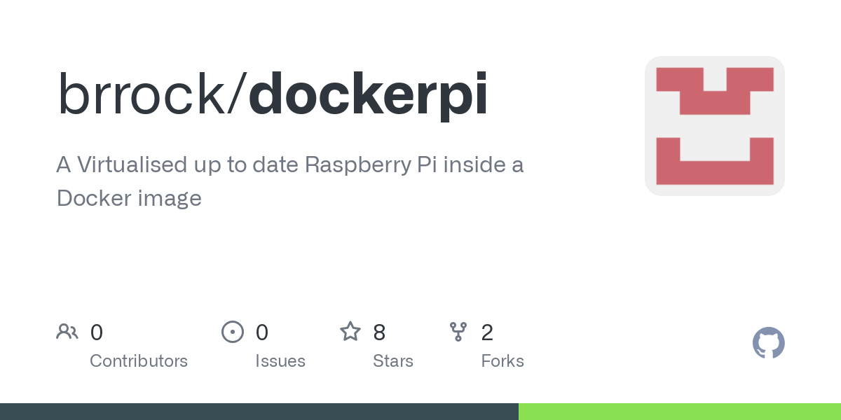

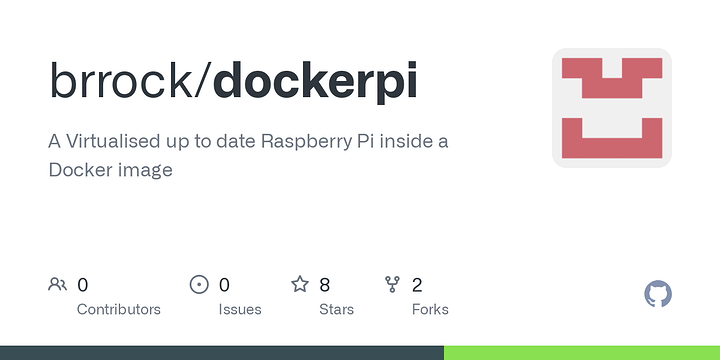

I found this, its a full emulated arm pi install in a x86 docker container if anyone is interested.
