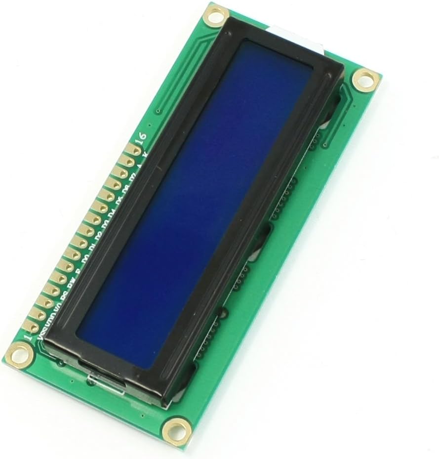

There are plenty cheap 16x2 and 20x4 LCDs that can be driven using Raspi or even a simple MCU like an Arduino.
Like this one:
These are very easy to program and play with. and you don't have to use a Raspi. An Arduino will do. You can also connect it to your computer and the internet to display various stuff that you want.

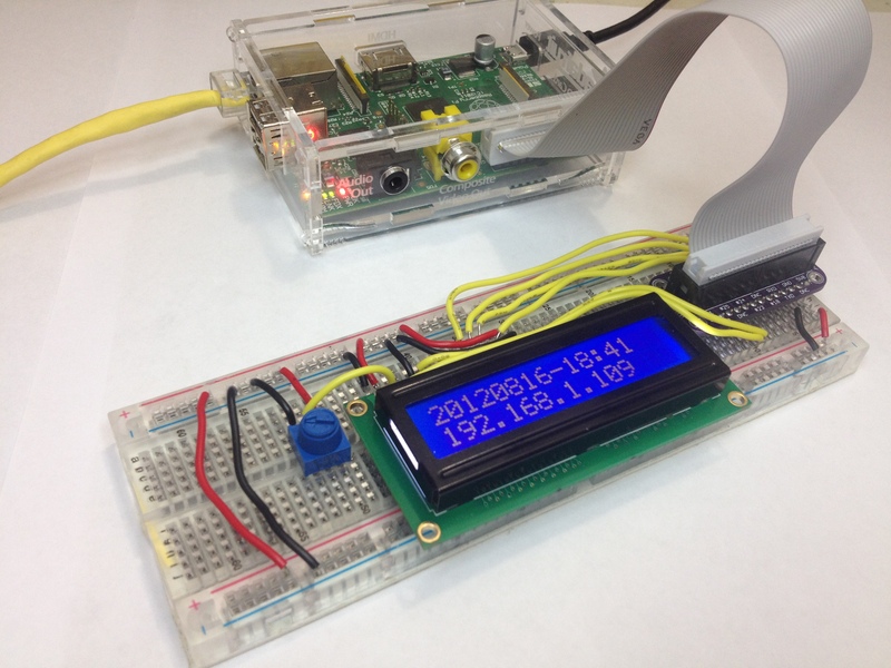

here is a little project that I've worked on last year
Lemme know if you're interested in the details. I'd be more than happy to help.

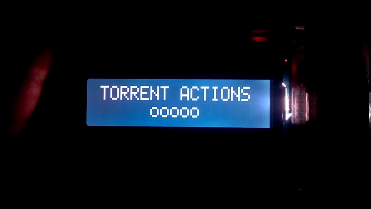

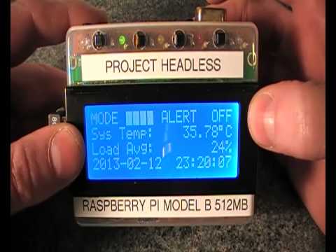

First of all thanks for the reply. Yeah, something along those lines but showing the system stats of my Raspberry Pi and than some. My idea is to have something like this:
but showing it on my phone (for money saving purposes). If cheap displays are a thing I would buy one to do such a project. Also I'm pretty much below basics when it comes to python and libraries to drive this kind of accessories.
P.S. I think 20x4 displays are interesting and I wouldn't need a keypad for inputs because my friends gifted me a sensors pack for this kind of integrated boards and it comes with a button and a joystick so I could use those as controls
P.P.S. the only thing that it's missing that project shown in the video is CPU temp. Other than that I think would be absolutely perfect for my needs for now (until I start learning how to tailor it to more specific needs)

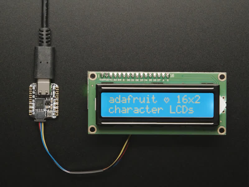

Now if you decide to get one of those LCD displays, just make sure to get it with serial interface module, This will save you the hassle of wiring down to 2 wires(Serial Clock and Serial Data). and they are cheap. usually a dollar or two. Or you can just buy the LCD with one of these included.

Here is a great article to get started
and another on how to wire an LCD with i2c chip
http://www.raspberrypi-spy.co.uk/2015/05/using-an-i2c-enabled-lcd-screen-with-the-raspberry-pi/
the latter is obviously easier to connect and requires less wires. Basically SDA+SCL+5v PWR+GND
The code can be written using C++ or Python or w/e you're familiar with. simply all you have to do is to import the necessary libraries and include them into your code. then its a simple logical statements. even tho I'm not that familiar with python, reading an example code was more than enough to get the job done.
after writing the code, you have to compile it into an executable file. then simply run the executable file. and ofc you can add it to be ran automatically at the startup of your PI. The adafruit article covers all these steps in details.

Different LCDs have different driver chips. Adafruit Liberary covers most of them to my knowledge (HD44780 Driver Chip which is used on almost all 16x2 and 20x4 LCDs). and even if your display isn't supported. usually you can find the correct libraries on github.
