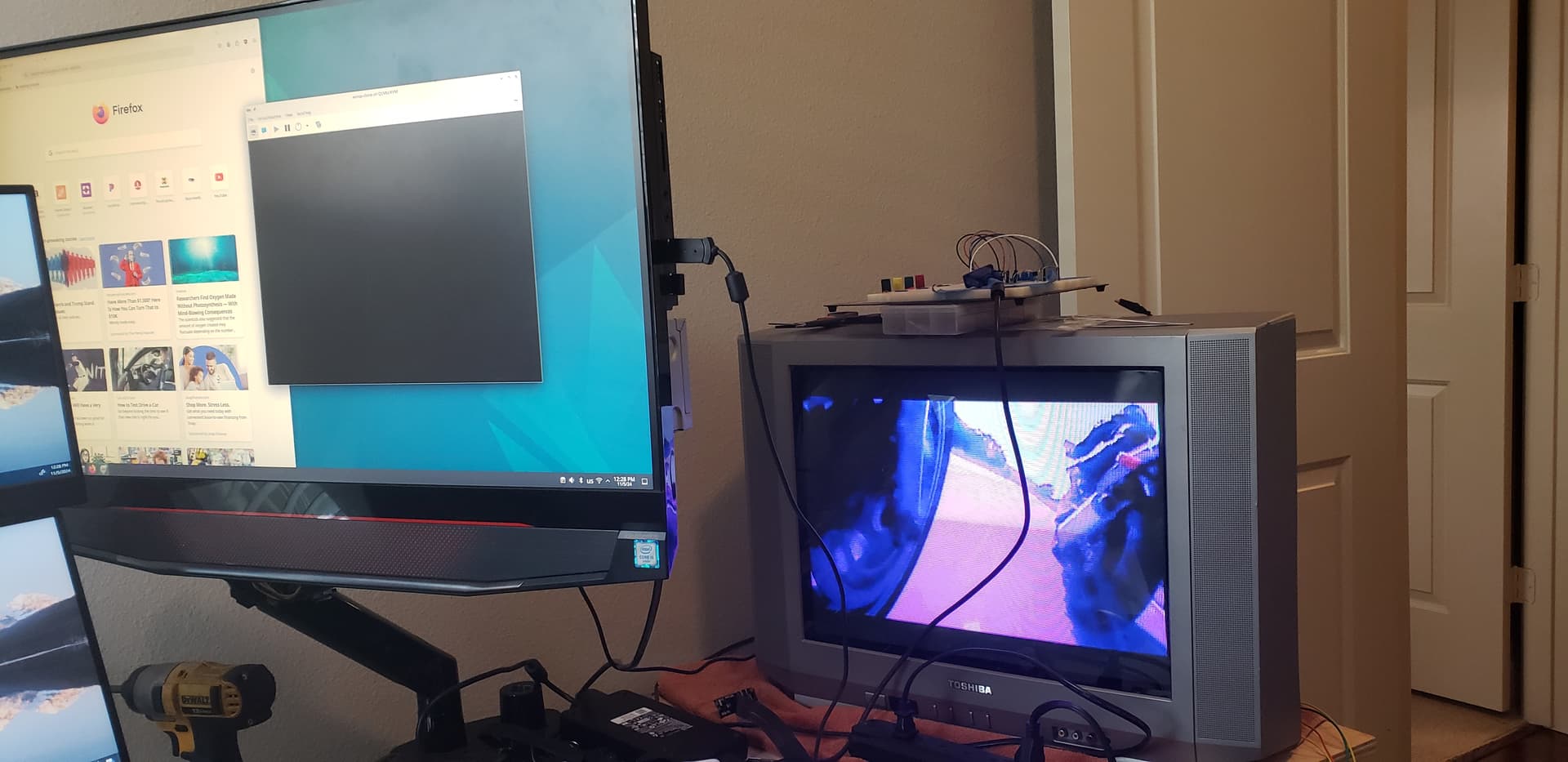

On and off over the last year or so I’ve been playing with different options to get some PC games going on an old CRT I was given. My current attempt is to pass an old 8600GT to a VM and use it’s S-VIDEO output.
Got IOMMU enabled, vfio_pci drivers bound, and everything works as expected. . . once per boot. When I reboot the host, I can successfully pass the GPU to a guest and get an output on the TV. After I reboot the guest, I get an error 10 in device manager (XP VM) until I reboot the host.

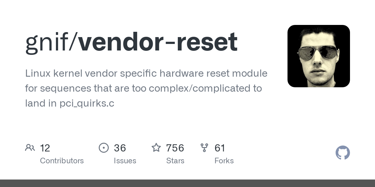

I’m working on figuring out if I can reset the card manually somehow. I’m starting with the vendor-reset module on github, but MAN I do not understand all of this yet lol

A cool picture of the fruits of my efforts thus far:

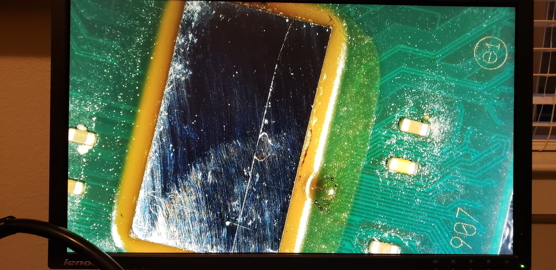

I did decide to pick up a thermal camera to check if it’s something easy to replace that shorted. I don’t have much hope, but I’ve gotten lucky on repairs before.
Isn’t it the hostswaping of the Gpu that shorted.
If this your experiment pc. Yeah then you defintly should fix it. Because that is part of the experiment. Get out your maginifier
Yeah, but if I can figure out exactly which components were damaged by the short I might be able to replace them.
EDIT: Turns out I just needed to turn my microscope on. That’ll do it lol
you’re being mooned by silicon. it is showing you its crack
