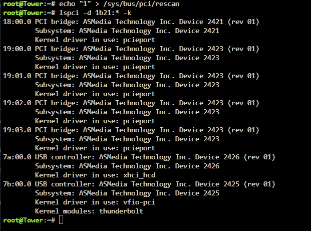

Even though I managed to reset the TBT controller manually and rebind it to VFIO, my first reboot of the VM in Unraid was unfortunately not successful.
I have to clarify though that I did a reboot without a hook-script in place meaning there was no way to reset the TBT controller. I did a reset before I started the VM. As long as I don’t have a hook-script in place that can trigger on reboot I will have to test with <start, stop, manual reset> cycles.
The only thing this indicates so far is that it doesn’t behave the same way as in Rawhide where 1 reset was enough. Not giving up yet. More testing tomorrow.

Ah, interesting. If I am in that situation I do an echo 1 > /sys/bus/pci/rescan.

Unfortunately <start/stop/hard-reset> cycles do not work. Not sure why this is working with Rawhide. Maybe the virtualization is the root cause or it might just be a newer kernel/driver that might fix it one day.
I have one last hope which is also hard-resetting the USB4 controller. I have seen that both parts of the chip seem to share a memory block. This will be tricky though. I cannot blacklist the USB driver otherwise all my other USB ports are useless. So I need to find a way to blacklist only a certain device from loading driver X or I need a way for a manually attaching a device with the VFIO driver instead of using /rescan. When I think of it, a temporary blacklisting might also work (if this is possible - this requires /rescan to read the blacklisting config whenever a driver needs to be loaded)

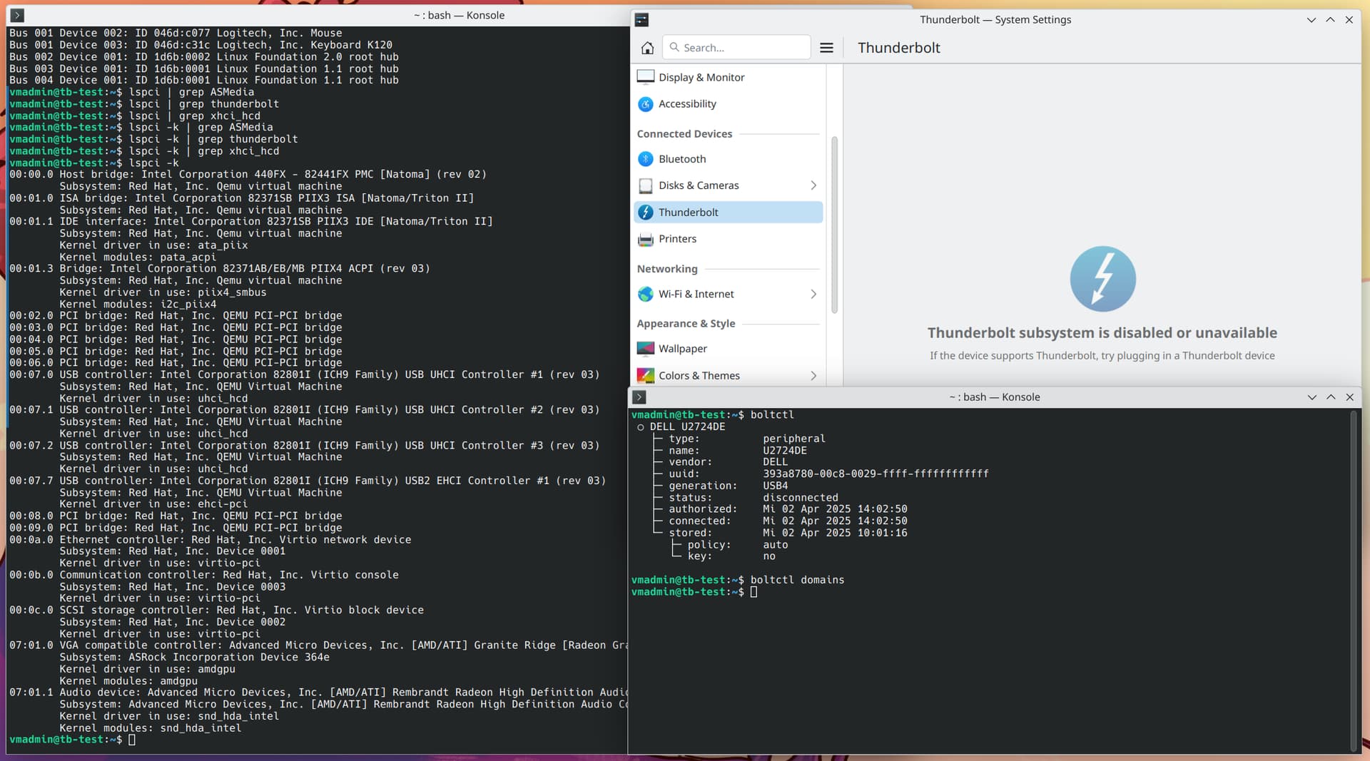

I have some very good news to report. Actually I’m typing this message on my daily VM running on Unraid. I’m copying data from my old rig to Unraid.
By chance I found the solution. So here is what happened:

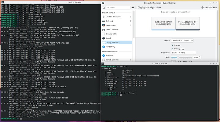

I got distracted by a phone call while my VM once again had the blackscreen issue. After the call I forgot that the VM was still running and was “hard-resetting” both the USB and TBT controller on the host. After that Unraid bound the USB controller to the USB driver (not blacklisted) and the Thunderbolt controller to VFIO (thunderbolt driver was blacklisted). Suddenly the monitor had a picture again (at this point I realized that the VM was still running). I would have expected at least a VM crash but all was running fine. Even more wired is the fact that neither VM nor the host had any drivers for Thunderbolt loaded but suddenly I could reboot start/stop the VM without any issues. This only broke after I power cycled the monitor (I guess detach/attach of the cable would have the same effect).
Here is a picture of the driver state
guest:
host:
tbt_insanity_3
This is when I realized that the only way this is possible is if Thunderbolt is only required for device authorization which happened in the VM when the controller was passed through. As long as the monitor was connected and powered on the authorization remained valid. If this is correct then passthrough of the Thunderbolt controller should also not be required.
