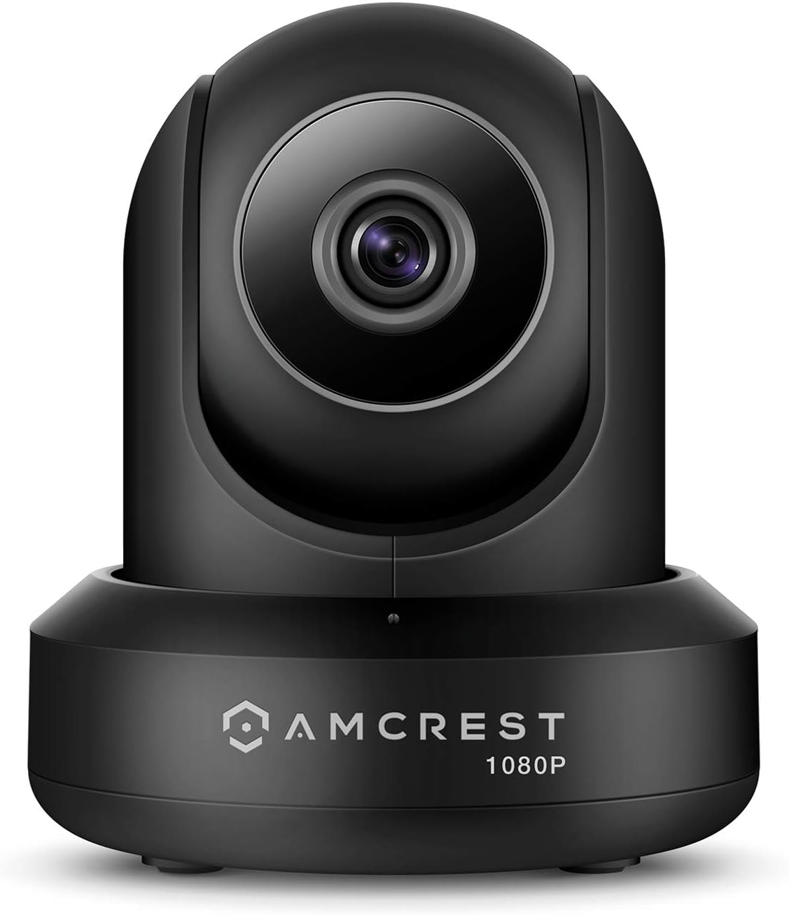

I don’t recommend old phones as security cameras. A real Wi-Fi security camera will have vastly superior performance in low-light conditions to a phone. Security cameras are so very inexpensive, it doesn’t make much sense to mess with an old phone… Seeing some for $20/$30/$40 on Amazon. They may have PTZ and other features you’d want, too. e.g.:

A bit of miscommunication… I plan on having a security camera on site. But there is no internet. So I want to use my phone as a hotspot to send the cam notifications to my personal phone. My old phone is a Samsung s-9+, and I’m pretty sure it has battery monitoring. The security camera I plan on using is a Wyze V3.
