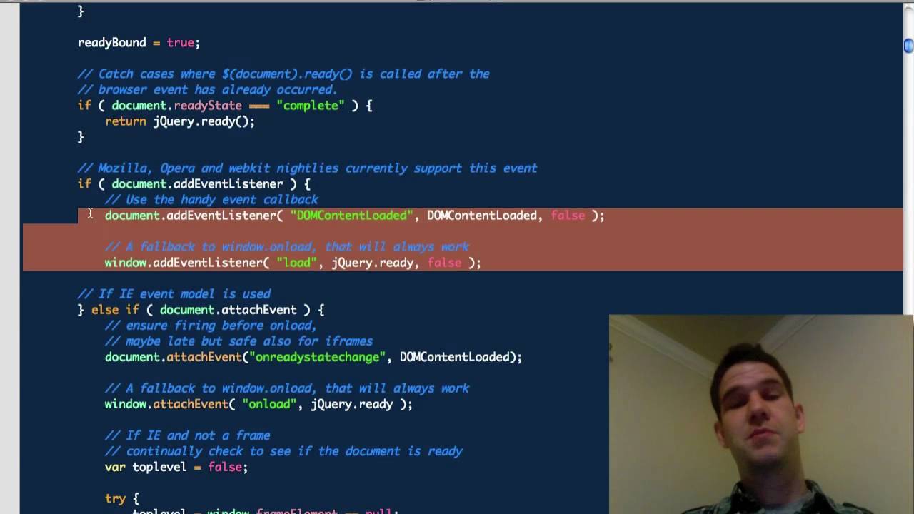

Though it’s quite old now this is also a rather interesting talk imo:
And the Followup:
