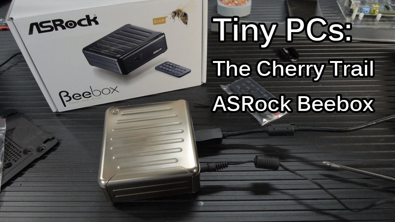

It would be possible to do all of this on a raspberry pi, but let me save you some head ache. The raspberry pi just doesn't have the horse power you will want in a server. Try an intel nuc or something. Here is one that Wendell reviewed.
the barebones model starts at $150 on newegg
