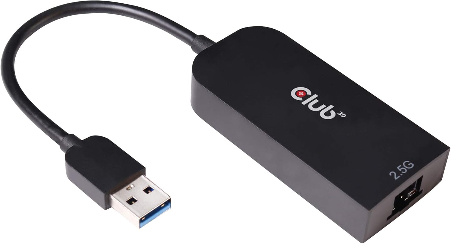

Wow, selection on amazon.nl is quite limited compared to the US. There are a few reputable brands but I would suggest tempering your expectations when it comes to performance. Most the 2.5G adapters will be using a realtek rtl8156 that doesn’t perform well under heavy load (such as with transferring large files from a NAS). The 5G adapters should do a little better but about 3.5Gbit will be the top end for them. There are some good reviews for 2.5/5G to USB adapters on ServeTheHome if you want to do some research first.
I’m assuming these are for the HP laptop from your other post? If so you can use either USB-C or a Type-A port. Both are USB 3.2 Gen 1x1 (5Gbit)
2.5G Adapters
