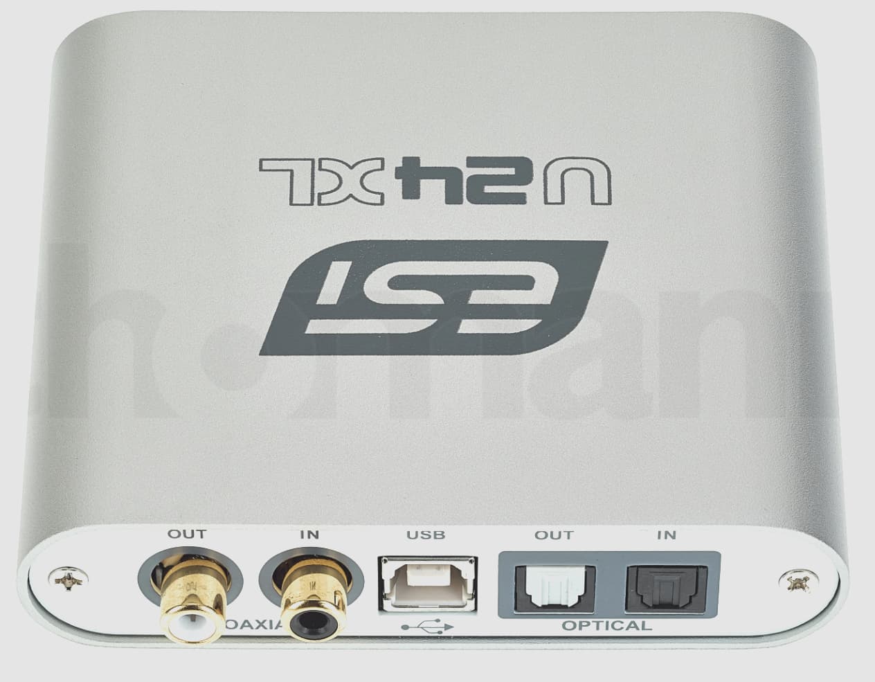

ESI U24 XL - for the sending computer
Plugs in via USB to a computer, then output via TOSLIN

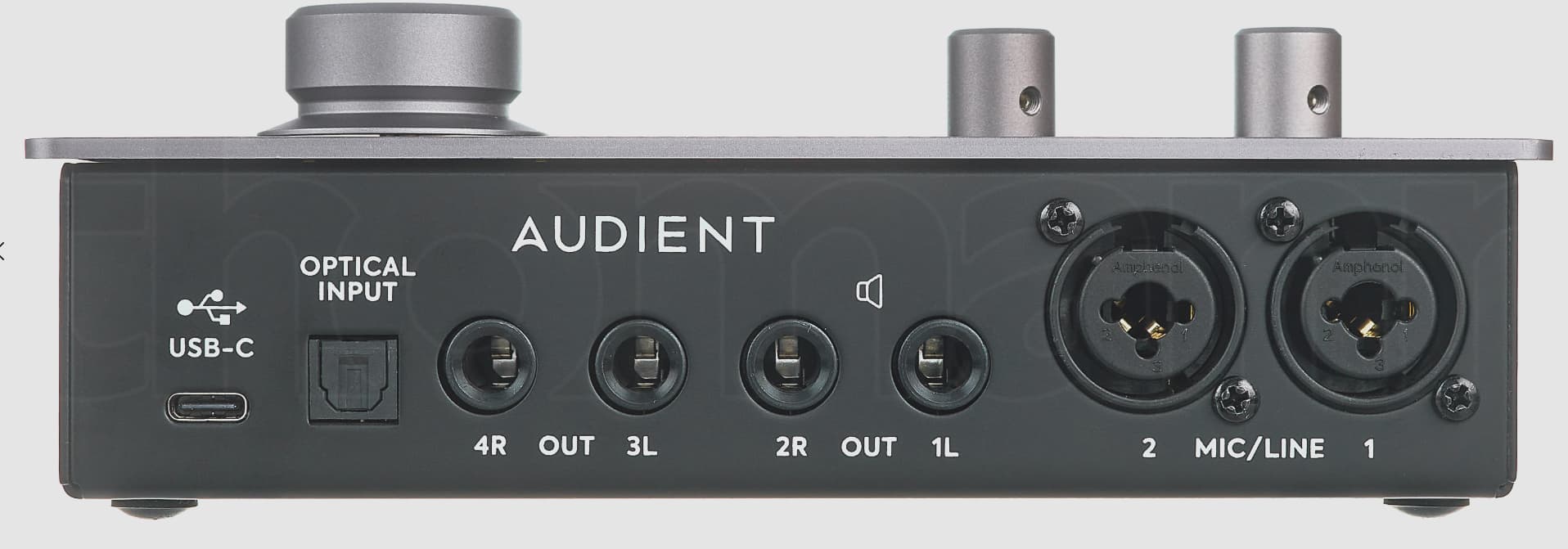

Audient iD14 MKII - for the “listening” side
And then set up the audient to play back the ADAT/TOSLINK input to whereever you need it.
I am researching a similar issue and ran into this post, hoping for a solution.
Sadly this is not it. The iD14’s input is ADAT (8-channel) over TOSLINK (2-channel) while the U24 has S/P-DIF over TOSLINK. The protocols are not compatible.

That is a bit strange since Audient in the manual specifically mentiones S/PDIF or 8-channel ADAT modes being selectable.
Ah, thanks! So they do have multi mode support (which from what I’ve found is quite rare!). The website I did check didn’t mention it or I’ve must have read over it. I use Focusrite Scarlett devices and they only support ADAT over TOSLINK. Some do also have S/P-DIF, but only over COAX.
