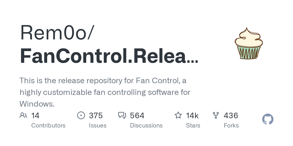

I have been using FanControl for the last 12months and am fully satisfied. I even donated to the developer.
This might be what you are looking for, even before you switch fans.
