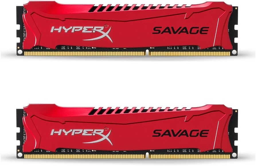

I am surprised the voltage is only 1.35, I have DDR3 2133 but it’s 1.65volts, it was really cheap when I bought it.

@risk woops I didn’t see it was laptop RAM.
Do you reckon this will work with my RAM?
Thanks!!

These have less clock speed and will slow down the ones you already have.
Just look for DDR3 2133Mhz Cl11 and XMP. The manufacturer is not as important as long as they are branded.
