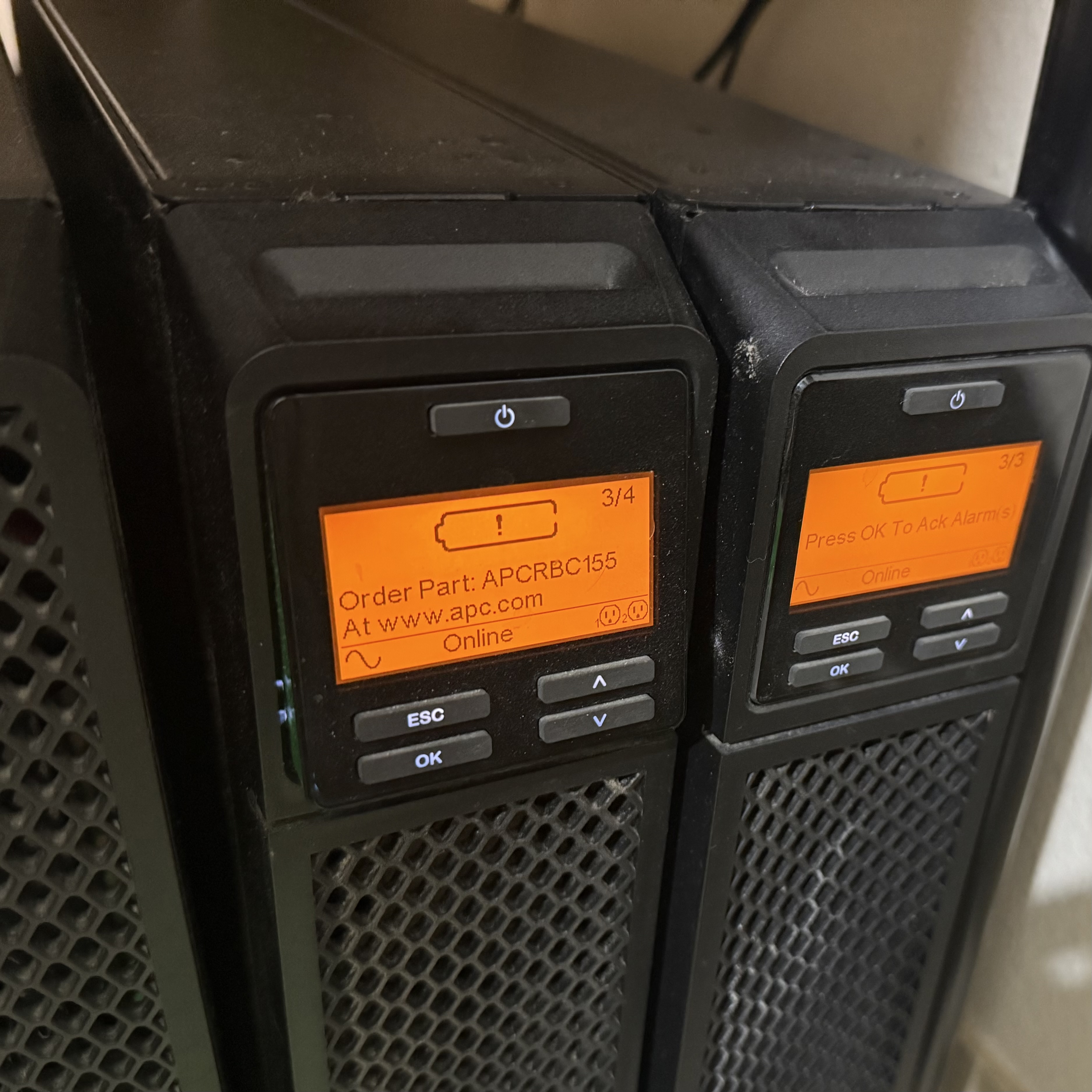

Hi I have a couple of inverter-type UPCs which have been giving me the “time to change the batteries” alert for perhaps 6 months. I have the new batteries for the main units (not for the battery expansion unit which is connected to the SRT1000XLA)
I always say that if you delay your haircut by an extra 2 weeks that is money in the bank :rofl:
So the question is… until when is advisable to run these units on the old batteries… I thought at some point the units were going to tell me “no mas” but they keep going.

You are right, there is a Runtime Test. Running it now!
The one that had said 40 mins took around 8 or 9 min to get depleted. I guess it is time to replace the batteries :joy:

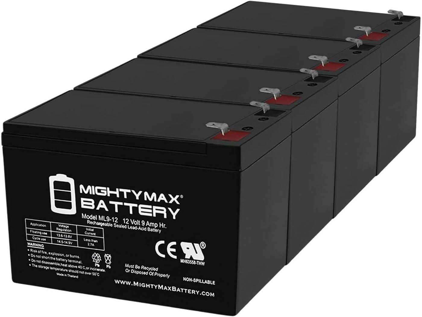

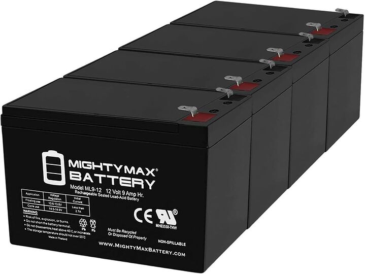

I replaced my batteries across my UPSs at about $20/battery
How?!! What batteries were those?
Make sure to match the battery type to your UPS.

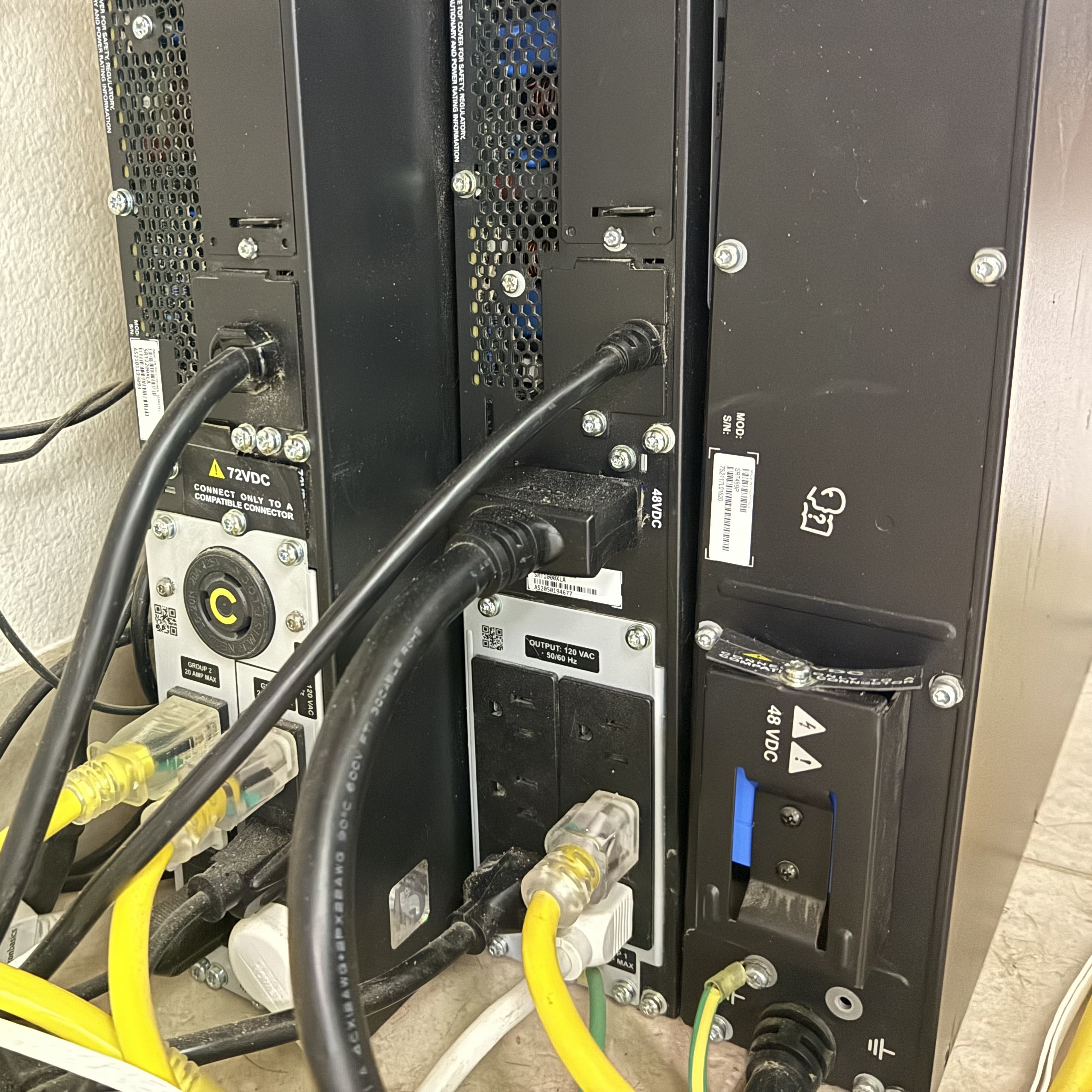

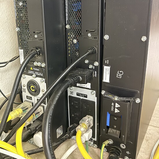

Now I have to figure out if I’m going to send the old cartridges back or keep them so that next time I can rebuild the batteries and swap cartridges. I should have gotten bigger units. One is 2200 and the other is only 1000. They use different battery packs… 48V and 72V if I remember right. Looking back I should have gotten two 2200. But the 1000 was the first one, and then I had to get the second one, the one which is 2200. Oh well. Not the first time, not the last time.
