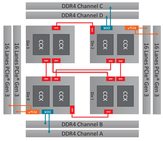

1socket 4 numa nodes

It’s not applicable for the 2990WX, as it simply doesn’t support the “Distributed” memory mode at all. Not in hardware at least, while the software / operating system of course may still choose to map continuous virtual memory to both NUMA nodes in an alternating pattern. (Achieves a remotely similar effect for random memory access, not so much for peak bandwidth on linear access though…)
Still got to ask though: On what base was memory bandwidth issues ruled out?
Affinity to a specific CPU means - even if the thread is spilling to other nodes due to the process exceeding the core count of the NUMA node - that all memory allocations happen on that specific NUMA node.
Correspondingly, when running a not NUMA aware application on a NUMA system, the (classic) default behavior is for the OS to ensure and assume that the entire process remains fully on a single NUMA node. As long as possible, at least, until either active threads or memory allocations spill.
Run Indigo 4 times in parallel on the 2990WX, each with only 16 threads, and it should scale as expected. Without messing with the default behavior of the Windows scheduler, obviously.
And please try dumping the heap for a “bad run”. I expect that you will see that memory allocations are also very lopsided towards a single node, matching the claimed affinities.
As far as I can tell on the basis that for the tested applications there was no performance difference between the octa channel EPYC and the quad channel Threadripper system when all other variables (cores, clockspeed, …) were equal (after the performance problem was “fixed”)
To me that is a reasonable conclusion. Probably it’s still possible to find memory (bandwidth) limited applications but that will always be the case and the Wendell tested real world applications.
Let me rephrase the question, on what base did you assume that you were actually using more than 2 memory channels of the quad / octa channel setups in the first place?
EDIT:
What I’m implying is, that you get a couple of peculiar effects if you put too much stress on a single NUMA node. Not only raw bandwidth, lantency and memory transactions, but also secondary effects, like hard bottlenecks in page fault interrupts and alike. Later ones are especially nasty on Windows.
So if your tested application isn’t NUMA aware, 2990WX as well as Epyc in NUMA mode are bound to perform only as good or even worse than a single module, aka Ryzen. In the worst case scenarios at least, but there are a couple of them, and not all are trivial.

One can’t ‘just’ disable it - for Epyc, but particularly Threadripper Non-Uniform Memory Access is a quintessential part of the design, of the very heart of the machine.
It needs to be understood, tweaked and harnessed to it’s full potential with AMD’s chips - not be a handycap like it’s largely been treated in the past.
NUMA can work great if the OS is properly aware of it - linux has demonstrated that to me and many others countless times - first in the data center and then the desktop.
